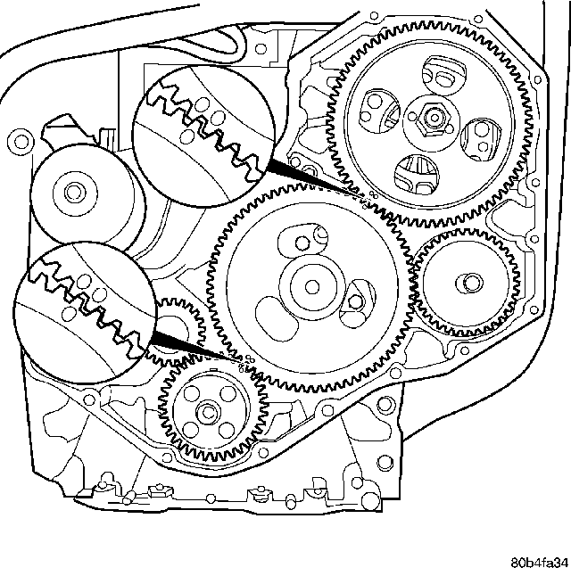

I am going to be replacing my injection pump soon and was going to pull the vacuum pump off and replace the seal and the o-rings since its so much easier with the injection pump out of the way. Can both of these pumps be taken off without causing issues with the injection pump drive gear? When the injection pump is taken out, the gear is left in the front cover and the new pump shaft is pushed back into it with the new key. Then I heard that the vacuum pump gear is driven by the injection pump gear......
So my question is, does this vacuum pump gear hold the injection pump gear in place when the injection pump is removed or will the injection pump gear stay in place with the vacuum pump removed?

No it doesn't, not all B series engine run anything at the acc. drive position, the Cam gear is what drives the Inj. gear, and the case would keep it from falling.

As long as you don't rotate the crankshaft, you'll be fine with the injection pump. I don't think there is any way for the gear to fall down into the case. A small bolt or the pump shaft key will drop down inside, so be careful there.
The vacuum pump doesn't care what position it's in when it is put back in. The camshaft gear drives both the accessory gear (vacuum pump) and the injection pump gear separately.

Vac gear is driven by camshaft gear so no problem.
