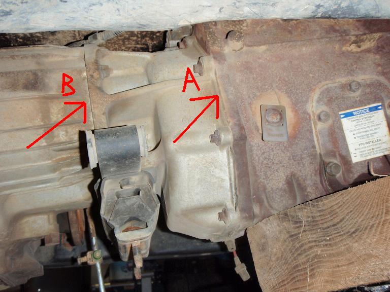

I have to take out my trans and replace the clutch. I figured this would be a good time to weld the 5th gear nut. My question is - Where do I separate the transmission and transfer case to get to the nut? right at the back of the transmission, or further towards the back of the truck near the transfer case. I see 2 places I could split it. thanks, -Evan

Old Nov 14, 2007 | 03:04 PM
Valv's Avatar
Posts: 1,376
From: North Carolina
B is to separate transfer case from transmission.
A is the rear transmission cover, that's where the 5th gear is under.
BTW I always thought the transmission looks like was originally a 4 speed and the "slapped" a 5th gear on the outside of it, it's almost completely separate from the other 4 gears.
