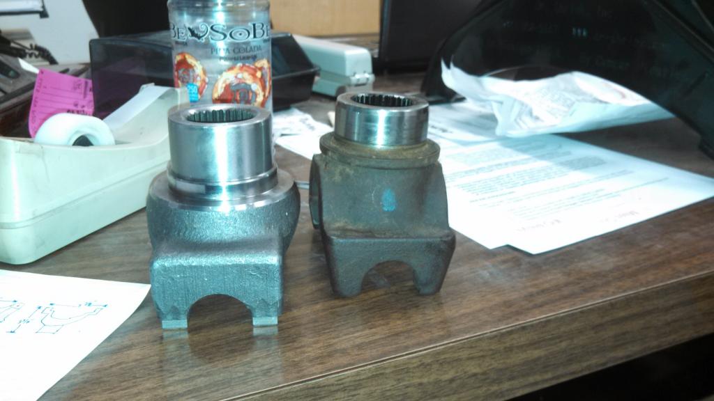

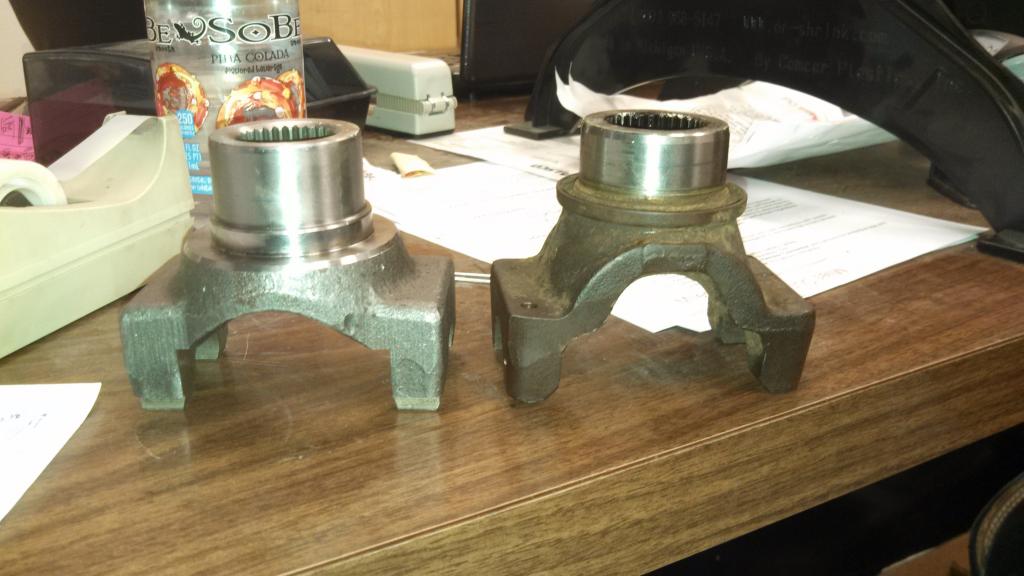

Had to replace the pinion yoke on the front axle. I can't do it (time and prefer to not roll in snow on a creeper) - Dodge in town could. Ordered a part from Randy's Ring & Pinion - Dodge 7290 pinion yoke.
Problem - the old yoke that was pulled out does not match what was ordered. Both yokes have the same ujoint cup size, same height - the difference being in the length of the "collar." See pictures below.
New yoke on the left, old on the right. Splines line up. But only removing the old yoke and placing the new yoke on the splines, the new yoke won't even seat enough to start the nut (so no further work was done). Dodge dealer should know what's going on but is there something blatant that is missing? Ideas? Thanks.

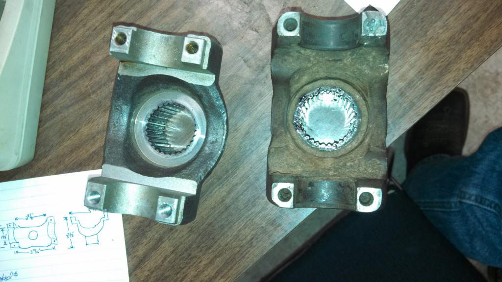

Also, below, the "depth" of where the splines start is the same measurement on both old and new.
Any help is greatly appreciated. Thanks.

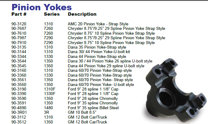

My supplier shows 3 different yokes, Maybe that got you a rear pinion yoke.

It looks to me like the new one uses a larger u-joint. The cup recess is definitely different between the two.
