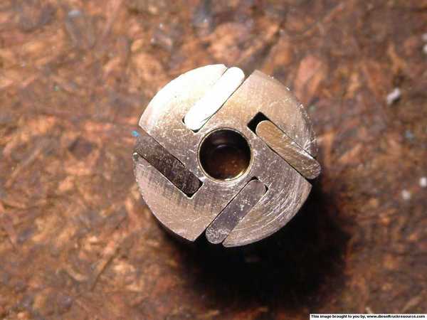

we caught ours the moment before the pump burnt up. what happens is in the housing is an impeller that is connected into the motor by a key and a bushing. the poor quality of the bushing comes into play when the fuel and time make it disintigrate. then the motor spins freely not pushing fuel so it burns up and give u a lack of fuel pressure.
note the empty circle where the bushing should be that connects it to the motor
