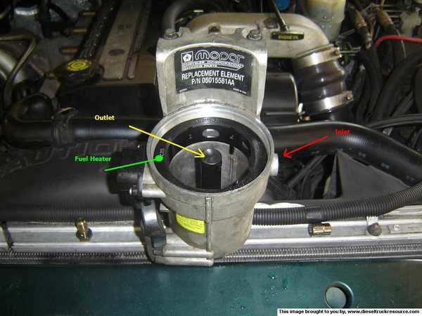

I second this method. If you remove the fuel filter housing you will have a lot more access to the pump. Two bolt on top hold the housing to the engine, however there are a few more item to remove before you pull it out. There are 2 banjo bolts (fuel fittings), one on the bottom and one on the rearward side. Also there are 2 electical connections, one for the WIF (water in fuel) sensor, and the other for the fuel heater. Here are some pictures to help you out.
Lift pump on engine : This shot is with the fuel filter housing removed. I used a catch bottle to collect residual fuel in the VP-44 and lines.
Fuel filter housing. This just highlights the main item on you FF housing. The inlet is noted in red on the right side.
Fuel filter housing 2 : Shown here are the electrical connections and the outlet. I forgot to highlight the outlet when I edited this picture. The outlet is the threaded hole on the bottom.
