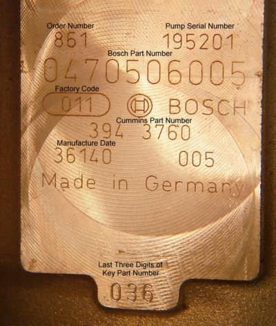

When the VP is rebuilt it goes through a calibration where the timing is set and a key number is assigned. The old info used to identify the pump is now not correct and has to be removed. In this picture you can see the info on my rebuilt pump. Notice the circular grind marks where the old stamped numbers were removed. The manufacture date will probably tell you when it was rebuilt but I am unable to find the magic decoder ring. This pump was purchased about 3 years ago.

Originally Posted by bent valves
... The old info used to identify the pump is now not correct and has to be removed.
Curious... PIC does not even show if it's a #27 or #28 (HO) pump. MY rebuilt still have original Pump model # and original SN (i assume) on it!
RJ

I believe the early VP44 pumps were not called 027, SO or 028, HO pumps and may have some differences from the newer pumps. When I purchased this pump for my 98.5 I had to give an engine serial number and it was considered a different pump from the standard 027.
I wonder if the current 027 pump would work.
...I wonder if the current 027 pump would work.
That's why I was confused! Ind Injections Company Store does not ask for CTD year. Just says #027 or #028 pump for 98.5 through 02.

Hey, thanks for the replies. I don't see those calibration #s on my pump. only two bar code stickers. one on top by the electric plug, and one where the calibration #s are in the pic.
