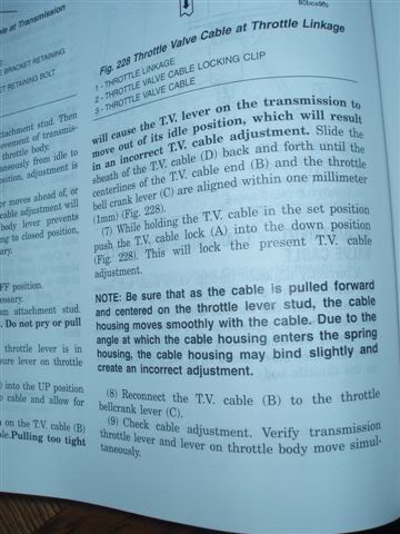

Old Aug 3, 2009 | 01:17 PM
johnh's Avatar
Joined: Nov 2002
Posts: 4,053
Likes: 29
From: lyman, utah
Size:  55.8 KBName:  P1010135.jpg

Old Aug 4, 2009 | 08:45 PM
fahtb0y's Avatar
Joined: Nov 2008
Posts: 131
hey johnh, is that a service manual?!
Old Aug 4, 2009 | 09:42 PM
johnh's Avatar
Joined: Nov 2002
Posts: 4,053
Likes: 29
From: lyman, utah
yep!.....................
