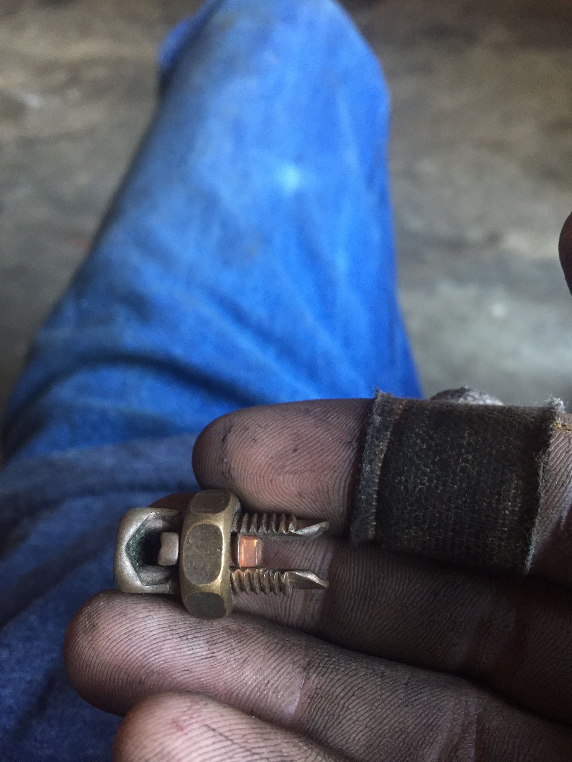

Well its got a little better system on than a wire tap sautered onto the end of the edge end. You guys would be ****** if I told u what I did and tell me how wire taps are the best but I broke 3 in the process and the auto parts store was closed at 11 so I improvised and it makes hella connection. But I could have been clearer on my explanation.

I sautered the edge wire into this for easier installation and hopes for better connection and stripped the vp with my pocket knife tightened this thing up good and liquid taped it then wrapped it in foam rubber with tape on top she’s not loosing connection. Farmers are very creative guys.
