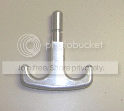

lary can offer these in the dtr online store once we get production going again
billet
