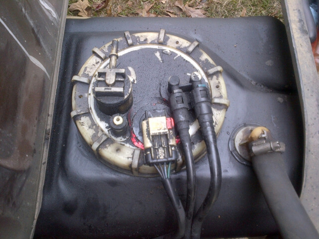

Hi guys. This weekend truck started running rough at highway speeds. Thought I had bad fuel. Changed filter and got worse then wouldn't start at all. So I thought I had a dead lift pump, got P1693 code, no scanner on hand so we checked pressure at filter and it looks like no pressure, AND no noise from the tank pump. Pulled the bed and found no power to any wires at the connector? We switched key on and off still no power at any wires. Any thoughts? I am looking for a schematic of this truck to verify wire color codes at connector. Is this a possible ECU failure not giving power to lift pump? Truck is at my dad's now and he will get a scanner hopefully this week to check for further codes.
Also, when I pulled the bed, I have to line fittings on the tank fitting that had no lines to them. First time I have been this far into the system so I have no clue what he open lines are. I attached a photo in hopes of getting info from you guys on what these missing lines are and what goes to them.
Thanks in advance for assistance.

That doesn't look like it has been converted to an in tank pump, are you sure they moved it to the tank? Look at the side of the engine, just below and behind the fuel filter for the lift pump. If it has been converted, there will be a block to bypass the pump, and a wire harness plugged into the original wiring running back to the tank.
I could be wrong here, but I remember more wires out of the sender than that for a conversion.
The additional ports are rollover valve ( bigger **** with horizontal barb ) and an axillary fuel port ( smaller one partially covered by a rubber plug ) plug is supposed to cap it off.

Mine had a red wire tapped off of the oem wiring harness that was located in the drivers side front wheel well towards the cab.. I too also thought the LP had died, ended up just being corrosion on that power wire... I ended up finding a used oem fuel module from a friends part truck that hadn't been converted.. I ripped that intake pump out and and now running a Raptor FRRP..
