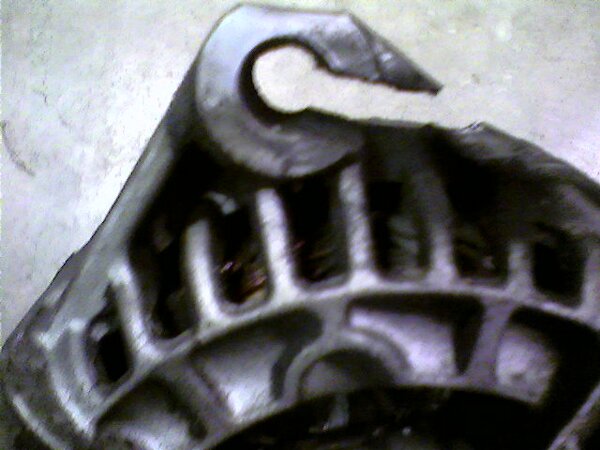

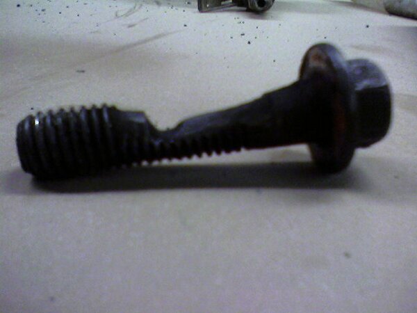

O and when i took off the alternator I discovered one of the bolts had worn right through the alternator housing and half way through the bolt. Check it out.
I think your alternator is moving when you get up to speed and then not charging due to belt slip.
With that much wear on the bolt and in the case that's a huge amount of travel.
