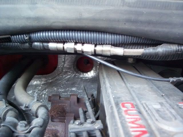

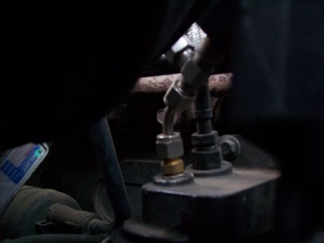

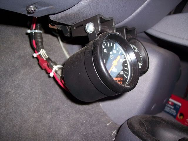

yup. The thread is 1/8" npt. I run the oil to a guage in the cab through 1/4" Swagelok SS braided tubing. I also have a ball valve installed in case I need to shut it off quick.
Connection -

SS Line -
Guage -

Nice setup there Dr. Evil. The ball valve is a great idea too.
I am not planning on running mine into the cab. Just something under the hood in case the oil pressure sensor goes out again. I am lucky with my truck being an 2001, it still has an actual pressure sensor and the oil pressure guage on my dash reacts accordingly.
