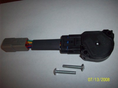

Accelerator Pedal Position Sensor
It is inside the black box on top of the air intake manifold at the front of the engine above the VP44 Injection Pump.
The part Tim supplies is behind the cable mount assembly under the black cover. Note that to get the cover off you need to remove the screws from the two inserts then remove the inserts as they go through the cover and the metal mount for it.
You will see the six wire electrical connector going up into the bottom to the back of the APPS.

Here is a pic. of the product.
