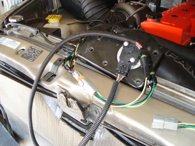

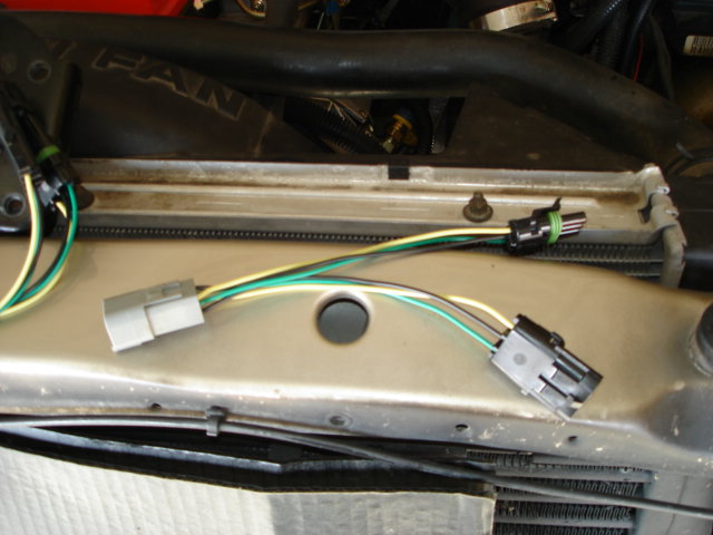

I would like to see some pics of what you get and the install. The tdr link wont work unless you are a member or the link is less than 7 days old.

timbo's is different than mine but you basically get an APPS (then sensor) with a connector cable made up that allows you to simply plug it into you exsisting wiring harness. Here's a picture of my jumper cable but like I said..timbo came up with a simpler, neater design.
Mike
