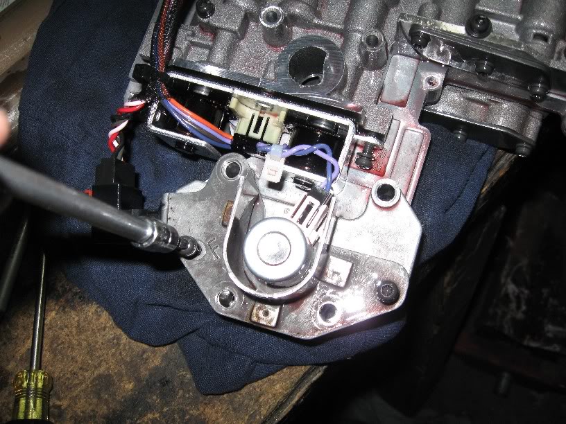

best if you scan it first, no sence replacing all the electronic stuff first.
here is a pic of the gov sensor/transducor

to my knowledge, 1-3 are mechanically shifted, only OD and TC lock up are electrically applied.
Gov sensor/transducor is need so tranny can use gov pressure signals to know when to shift,
someone more knowledgeable hopefully will chime in

that picture is awesome!! i did not take the top part of the valve body off, only the bottom part. i am going back in today and pulling the whole valve body off and cleaning all the rest of the valves in there and replacing electronics. my wire connector that sticks out on top seems like its not pluging in all the way, it doesnt click or anything. it only goes halfway, like theres something in there not letting it go, i could be wrong. im going to look at that as well, i am getting codes for shift solonoids, transducer and all that good stuff in there, but i dont know if its from driving without that plug plugged in or what, im going to fix it today though! can i change bands without pulling transmission?

i got it fixed!!! the transducer governor whatever its called was all plugged up!! the little screen on there was gooped, i got a new one and it shift smooth as glass now!!! cost 200 bux sensors fluid brake cleen everything! thank you nickg!! you nailed it
