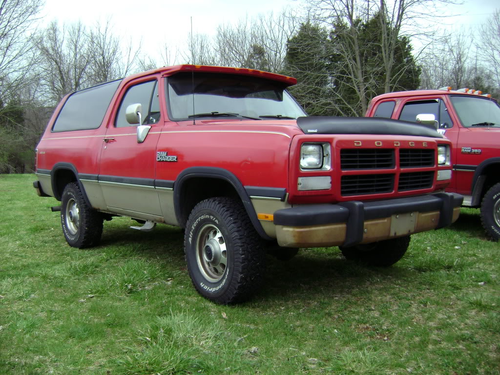

Thanks Crossy. The wheels will be factory 16"s. I have always wanted to do a RC conversion. I bought the RC 2 yrs ago as a spare for my current DD. Now I have decided to swap it. I know the look I want, I am trying to find a donor truck. If I do I will use its springs and have them rearched if needed to get the tires to fit. I am so excited, I always wanted one! Here is what I am using!

I am Crossy, I bought a D60 and D71 off a 1990 W250 from a fellow member on here a few years back. The tires I am referring to are not the ones on the RC currently. They are almost new as well but they are 31x10.50 15's. I have the tires and rears in storage. They have been waiting patiently for the day to go under a new ride.
