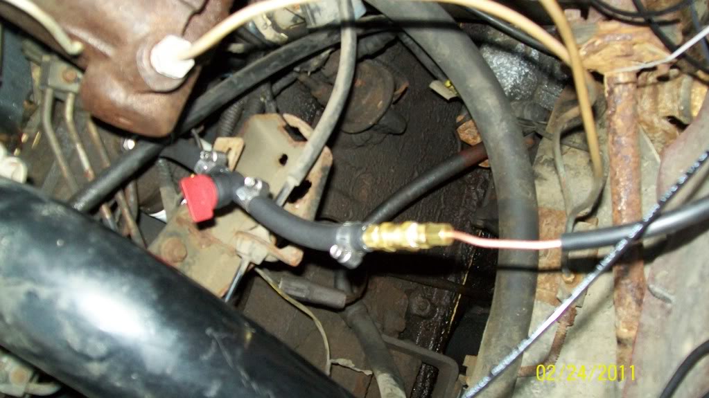

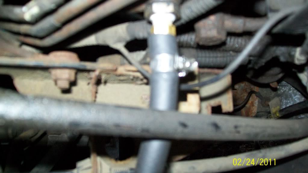

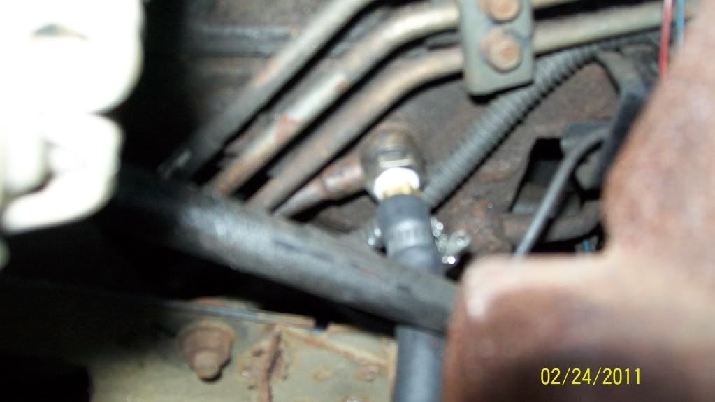

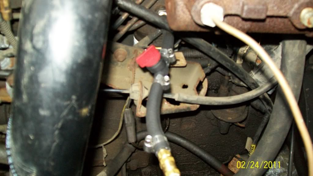

Richie,
Would you mind posting a picture of your setup ? That would help us out tremendously..... you know the guys who can't visualize as well as others...
Thanks !
T.

Originally Posted by NJTman
Richie,
Thanks !
T.
