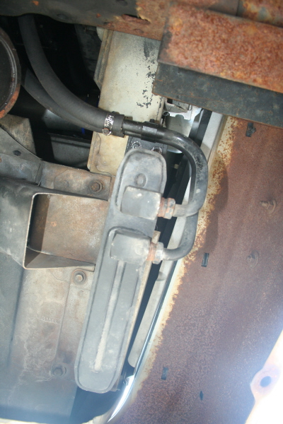

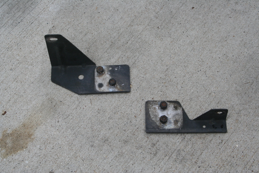

I just pulled the stock mounting brackets - pic 1
and drilled a couple of holes in the grille valance and mounted it there - pic 2

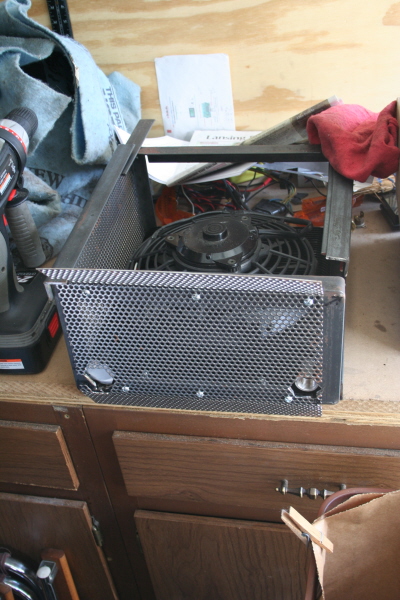

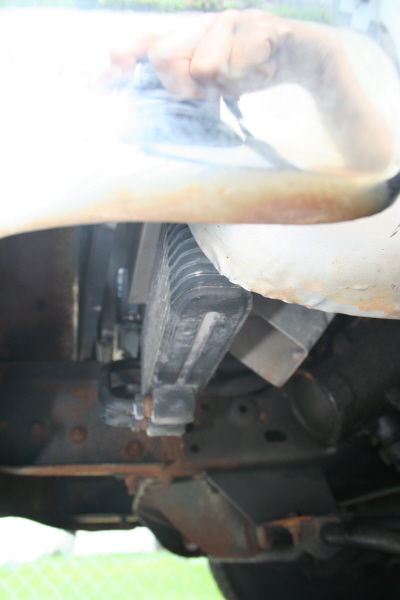

and it sits just behind the lower lip of the front bumper - pic 3...Was kind of guessing with the pic because I had the camera sitting on the ground but the front lip of the bumper is ~ 1/2" out of the pic to the left. I figure the turbulence created by the bumper will suck enough air up into the cooler to let it work - after a fashion. I'm not real concerned because the next mod will be :
pic 4 - soon to be installed under the bed 29K btu's of cooling.
