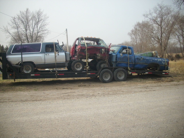

Not to-day, but a while back, this happened.
Decent payday.
Mark.
