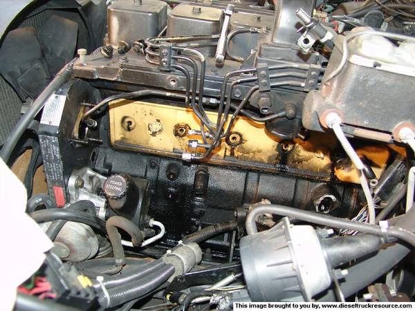

Here's a shot of the upper pump diaphragm in the lower left corner behind the steering box; the second one, out of sight but underneath the first behind the frame channel, mounts with the diaphragm chamber horizontal, that is, 90degrees to the one in view.
Both vacuum pumps have mounts that use four small screws to attach each pump on to a large flange with the drive gear and a drive shaft through it. The large flange bolts inside a bore in the back of the timing gear cover. The power steering pump bolts up to back end of that vacuum pump flange.
You can see the tee just above the visible chamber. I connected both hoses to the brake chamber.
Does this help?

One sits horizontally upsidedown and the other sits vertically on the drivers side. A factory service manual diesel supplement is what you need. Everyone with one of these CTD's needs to invest in a set of FSM's.

Well it looks like I am missing some parts. Mine has no provisions for mounting a second pump between the timing cover and the power steering pump.

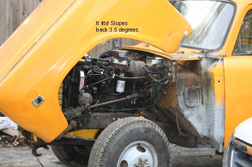

Yes it is. It's a '75 Model 200 with a Mayer dump body on it.
Couldn't stand to throw it away after I dug out my basement and used it to haul away about 100 cubic yards of dirt, so I found a wrecked Cummins, repaired it, and bought a getrag on ebay. I found a set of Kenworth hood hinges in my neighborhood and made it a tilt hood so I could get to the engine.
Runs good. I get about 13 mpg with the 410 gears in the differentials, but it beats the 7 or 8 that the 345 got.
Jim
aka dumptruck200

There are 2 diaphragms on our vacuum pumps, sometimes when one starts leaking they are disconnected and the line capped off.

the early model trucks had two diaphragm pumps on one bracket. They are the same as the ones on a 6.2-6.5 GM diesel. I thought he meant the small line coming off of the big one that goes to the cruise and the A/C controls.

Thanks guys for the pictures, that was exactly what I was looking for. I guess it is true a picture is worth a 1000 words.
