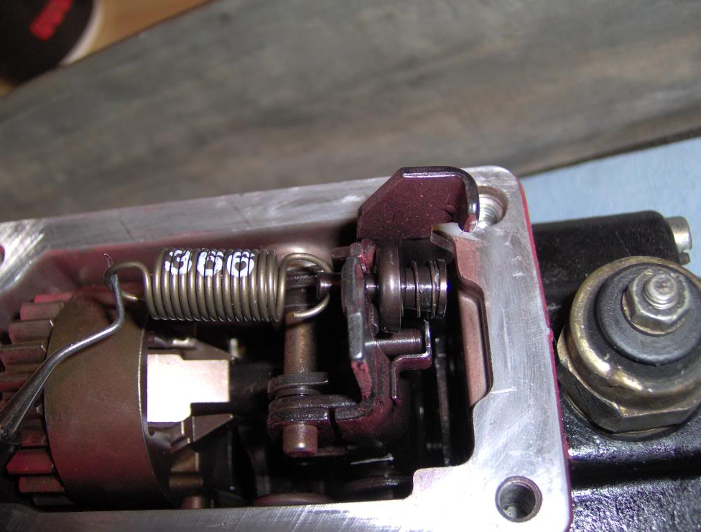

Here is a pic from 1stGen545's thread on the VE pump rebuild. You can see the pin below the top hat and spring. Now in this pic there is no spring on the pin, is this correct or not?
I need to know if I have to pull the pump and tear it down to see what damage might have occurred if the spring did drop into the body.

Try fishing with a magnet. The idle spring is not likely to have damaged anything, it's light and fragile so it would be more likely to be what broke.
So without the that light little spring she won't idle or fire?

It makes the governer lever too loose, it's like clocking the throttle lever too loose. If you got it running it would surge bad at idle.
