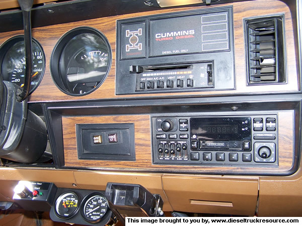

I am looking at a 1990 1ton with a CTD that is for sale. It has transmission problems. The transmission shop told me a rebuilt overdrive trans would be 1500.00. If it is not an overdrive it is 500.00. The shift indicator has 1,2,D. I am thinking if it was an overdrive there would be an O around the D on the shift indicator. Can anyone with a 1990 and an automatic overdrive tell me if I am correct? Thanks. Kirk
Old Aug 16, 2006 | 03:46 PM
G1625S's Avatar
Joined: Mar 2004
Posts: 4,767
Likes: 5
From: port crane, NY
if it has overdrive, there should be an overdrive lockout switch on the dash.
Old Aug 16, 2006 | 03:48 PM
Kirk T's Avatar
Posts: 26
From: NW Oklahoma
Where is it located? I just looked at the shift indicator.
Old Aug 16, 2006 | 03:49 PM
G1625S's Avatar
Joined: Mar 2004
Posts: 4,767
Likes: 5
If I recall (I drive a handshaker) it will be located to the left and lower than the steering wheel, next to the cargo light switch.
Old Aug 16, 2006 | 04:24 PM
jrussell's Avatar
Posts: 3,660
From: Florida
Here's a pic of the OD lockout switch (above gauges, next to cargo light switch):

If it's a '90 it won't have an overdrive. '91 was the first year for the 4 speed automatic with the diesel.
