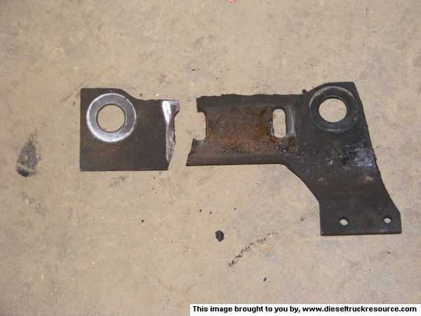

http://i289.photobucket.com/albums/l...s/DSCF5043.jpg
http://i289.photobucket.com/albums/l...s/DSCF4512.jpg
http://i289.photobucket.com/albums/l...s/DSCF4422.jpg
with the manual you can break things too
