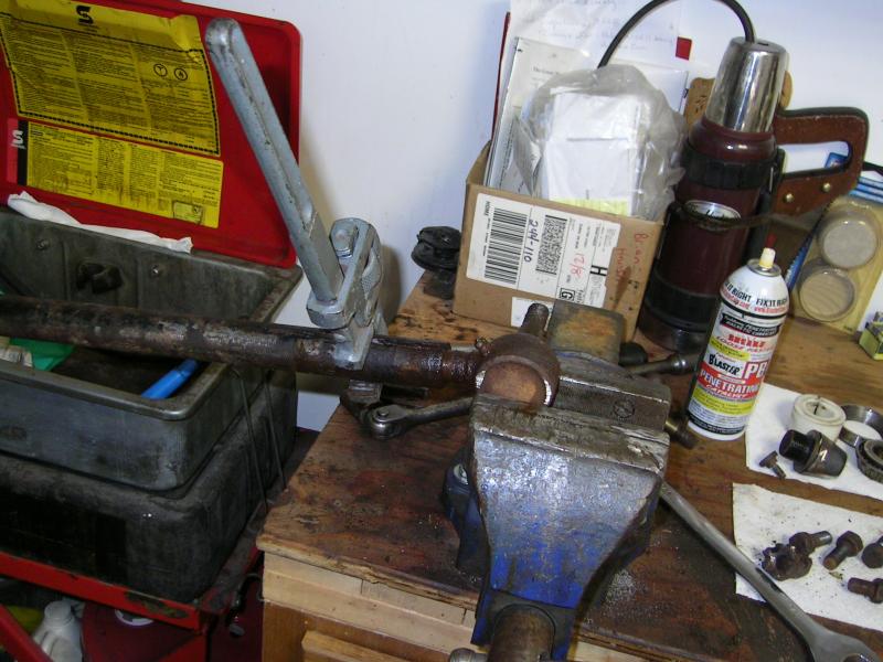

I just recently redid the front end on my donor 93...and the tie rods were in there good! Eventually I had to clamp the tie rod in the vice and then use a pipe wrench to spin the bar. Even then it took a lot of heat and PB Blaster to get them out.
I too would love a replacement bar...since the threads were so rusty on the old tie rods that it deformed the thread pattern coming out, and now the new ones are very tuff to spin in and out.
Here's a pic of what I had to do....

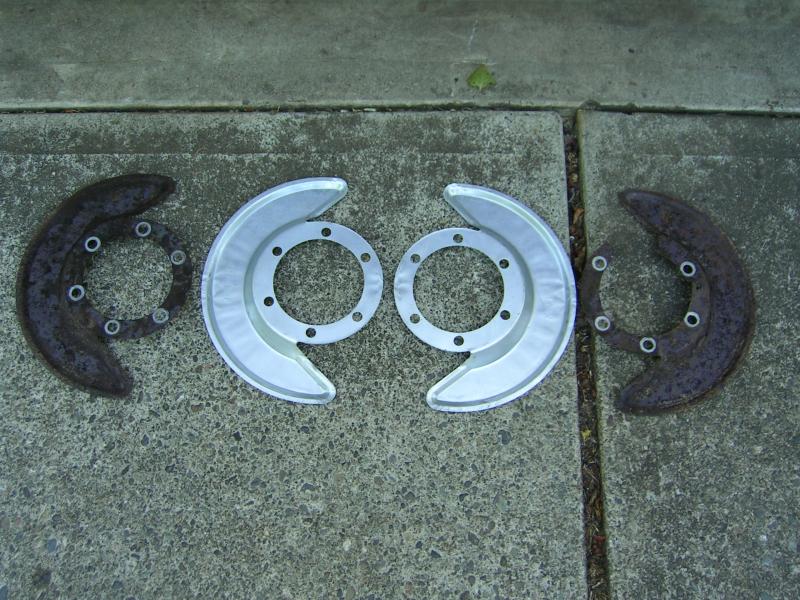

TC,
Where did you find these ??
I don't need them, YET, but it seems that they all rot out over time.
Old Aug 10, 2013 | 05:38 PM
I got them off E-bay. brandis4x4performance was the seller. $70 for the pair seemed steep...but I needed them.
