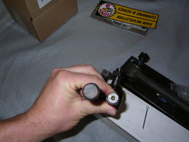

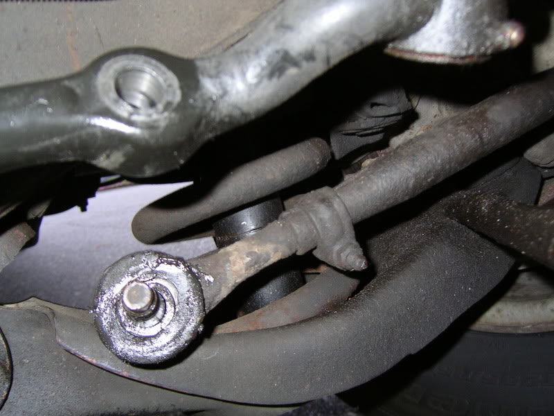

Here are a couple pics,
Now the tie rods are toast, but they should still be seated nice and tight. They are being held in with a couple extra washers under the castle nuts!! Never seen that before.
So I pulled one of them loose, just removed the cotter pin and nut, and the tie rod fell out. So I took some measurements and this is what I have.
Original tie rod...on the tapper... 0.704 to 0.635
New center link...on the tapper... 0.754 to 0.661
So as you can see there is way no way the tie rod could ever fit tight into the new center link. So here is my question, since this was a D350 gasser originals would it run a smaller tie rod then a diesel? I have been searching for new tie rods and have a set of ES2120R ad ES2121L from NAPA coming in, these are for a gasser D350. I'm thinking maybe the new center link is for a diesel D350? Did they run a bigger tie rod?

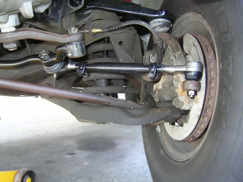

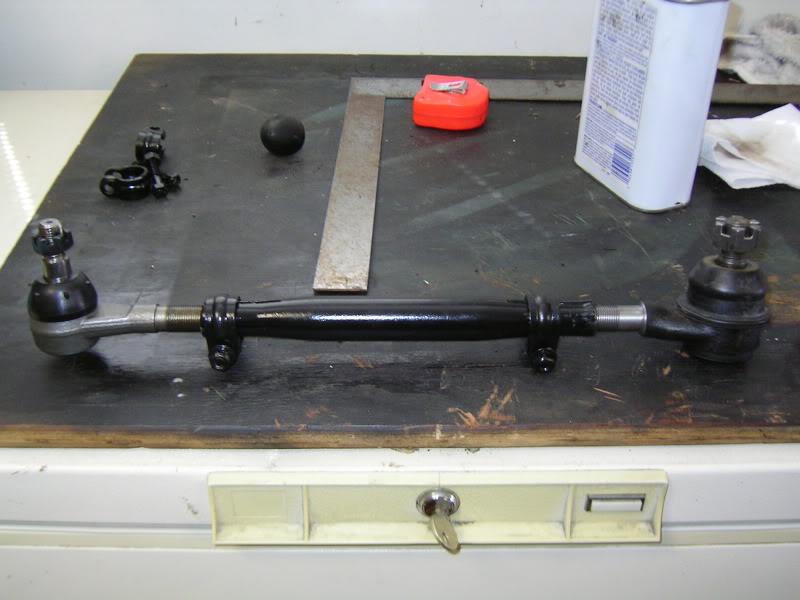

Can someone post a pic of their tie rod end configuration from there factory diesel D250-D350 2wd truck?
Old Jun 1, 2010 | 02:30 PM
jimbo486's Avatar
Posts: 4,389
Likes: 114
these are moog replacements but still the original setup.
driver side:
passenger side:
Old Jun 1, 2010 | 09:25 PM
Thanks for the pics Jimbo!!

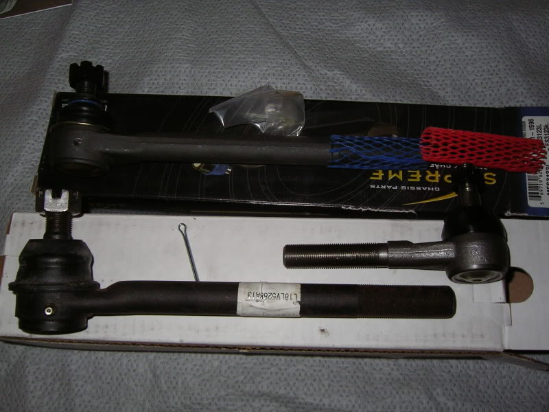

I ordered all new tie rods, two diesel inner tie rods, and two gasser outer. Here is a pair of the new ones. You can see the difference!!
So to get around having to find a set of diesel lower ball joint arms and such, I decided to have the big diesel tie rods machined down to fit the gasser adjustment sleeve, and therefore have the proper size end and tapper to fit the diesel center link.
I found a local guy who works out of his back yard. I brought him in one of the old used gasser inner tie rod and adjustment sleeve, and the two diesel units. He then milled down the shaft size and threaded them, Left hand thread of course. He said the hardest part was figuring out how to mount the tie rods in the milling machine since the odd shaped tie rod head was too big for his chucks. He ended up having to pin them on each side, center them, then mill them down, then thread them, then cut them to size.
Diesel and gasser tie rods.

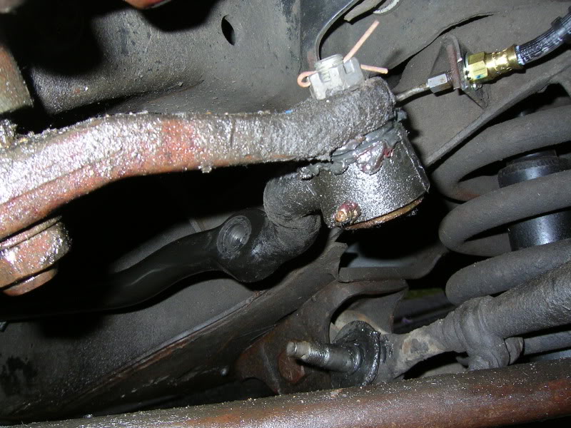

And them assembled in the sleeve.
And now mounted in the truck.
I have also redone my upper control arms, so after the VE pump is re-sealed, new piston pump installed, new fuel heater and lines, I will get the front end realigned.
Hope this helps others out.
