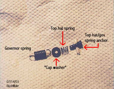

This is how I have had mine assembled
I'm going to put it back together with the correct spring in it since I managed to find the one I lost originally and see if that was all that was causing me grief.

Yep you have it right, that was my problem I assume, I don't know what else it could have been. Hope you get yours worked out.

Put it back together with the original top hat spring and it seems to be back to working correctly. Guess these things are a little more precise than I figured
And it is soooo much easier to just pop the throttle shaft out of the housing to hook up the spring versus trying to leave it in and stretch the spring over and hook it on then it not hooking and sending the top hat bits off into oblivion.
