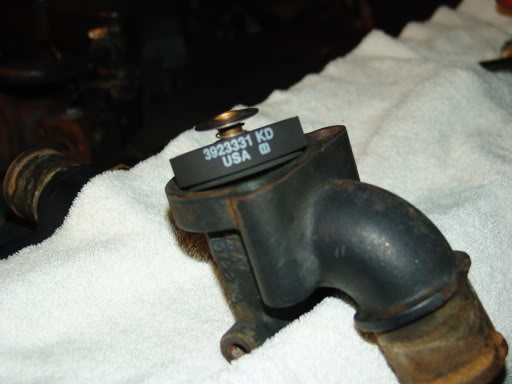

Here is the one I used #3923331
Here are some more pictures of the thermostat and housing.
https://www.dieseltruckresource.com/...6&postcount=10
Jim

jim, i have the seal you have in the picture. i picked the t-stat kit up from valley freightliner using my engine number...
the picture i posted is from alldata. selected 1993 dodge w250 diesel. and to double check i looked at the info for a 1992, same picture.
if it comes off again after that... im putting some of my magic locktite flange sealant on the housings and calling it good. it wont leak after that.
