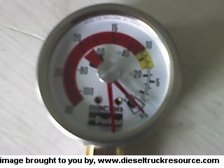

i got this gauge given to me. i believe it measures suction. was from a racor filter setup. can i use this for my truck? do i even want to?

I'd rather have a pressure gauge after the filter to monitor filter condition and fuel delivery. All that will tell you on a stock Dodge fuel system is whether or not the tank pickup is restricted. The only reason to use one of those gauges is to monitor a pre lift pump filter (like a Racor).

Could it be plumbed into the intake hose after the filter & before the turbo to monitor the air filter?

don't know. how much vacuum is created at the air filter. i have heard that the filter minders don't work for nothing

Since that gauge is for a fuel filter I imagine it's calibrated in inches of mercury. Air filter restriction is measured in inches of water.
Translation - it'll barely move with a clogged air filter.
I second that, I had a air filter guage on my bigtruck to measure the restriction, and its in inches of water.

put it on the brake vacume thing, just a thought

Yes why not plum it into the vacuum pump line if it reads vacuum and mount it somewhere on the dash. It will look impressive if you like the looks of lots of gauges.......
