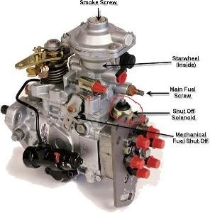

What does Fss stand for?
Old May 12, 2018 | 05:26 AM
Angry Johnny's Avatar
Posts: 939
Likes: 264
Fuel shutoff solenoid.

That would be the fuel shut off solenoid on the ve pump, It will keep the engine from starting while you turn it over.
