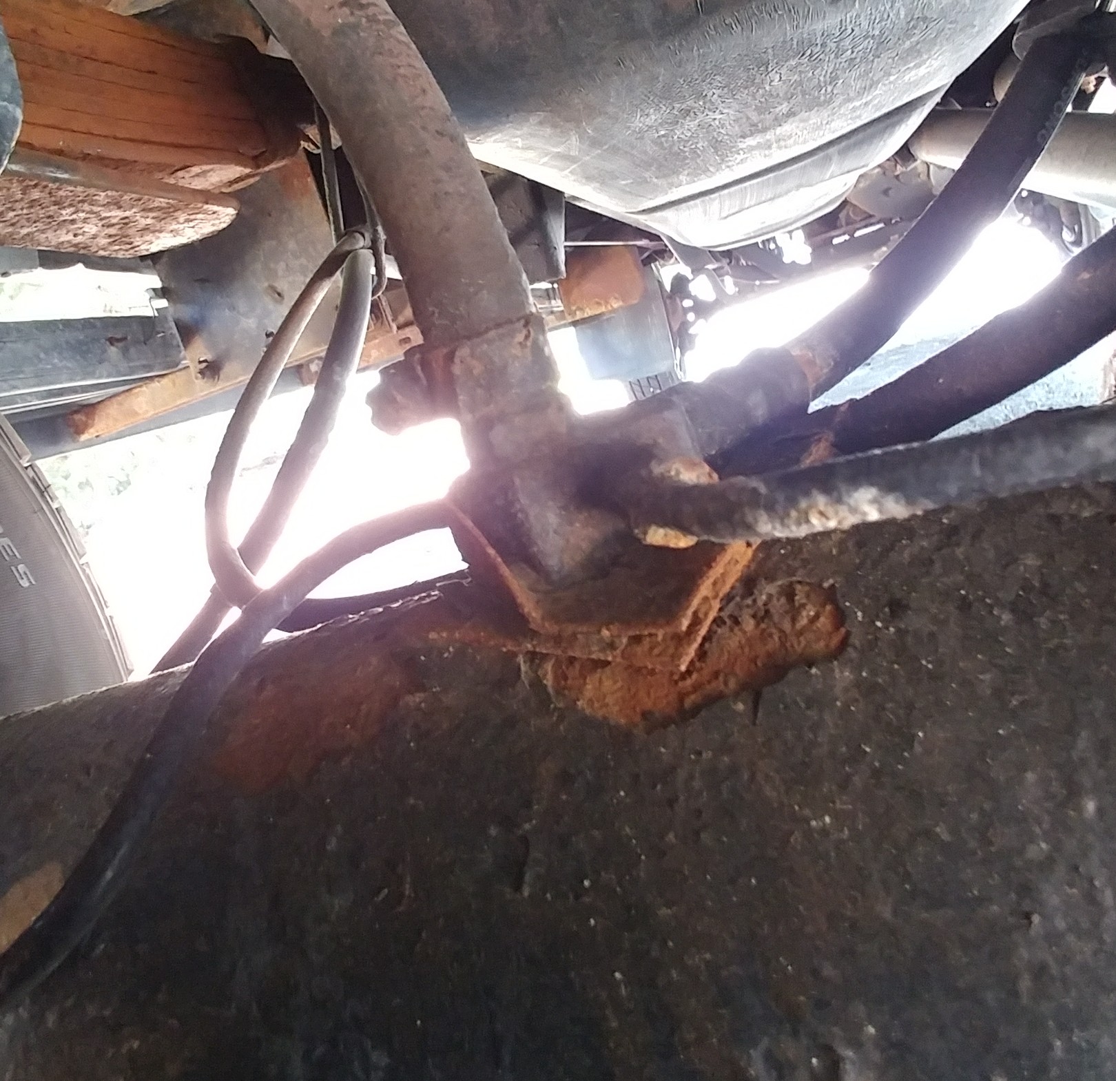

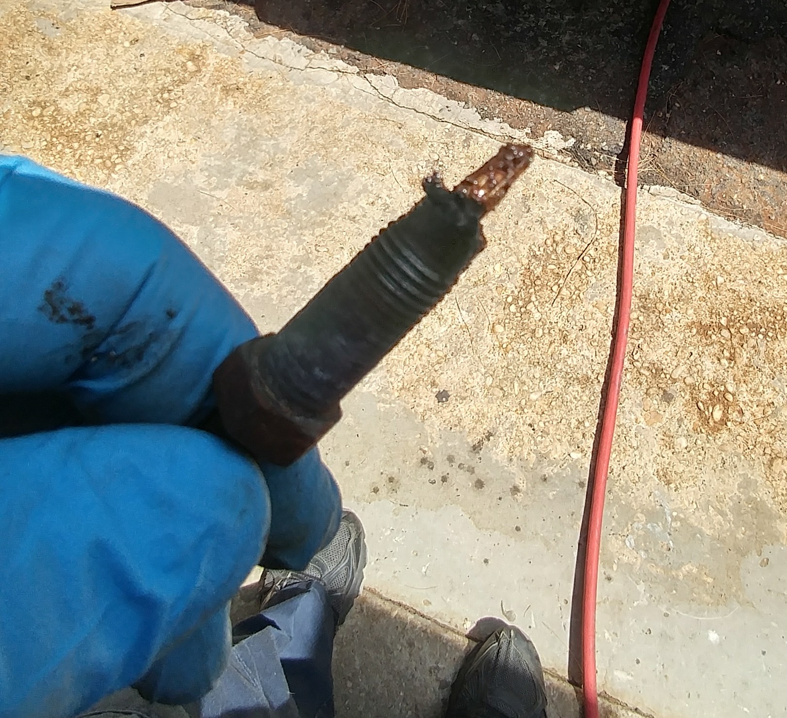

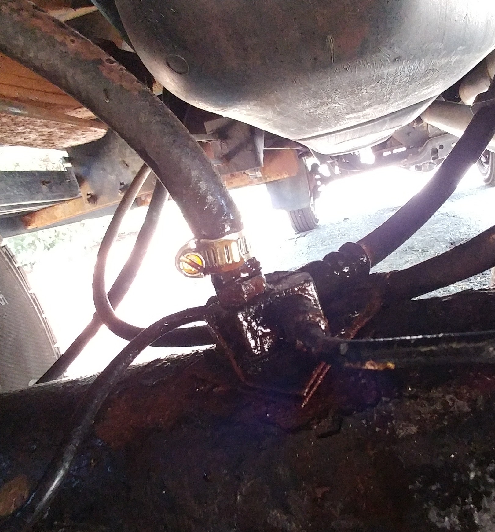

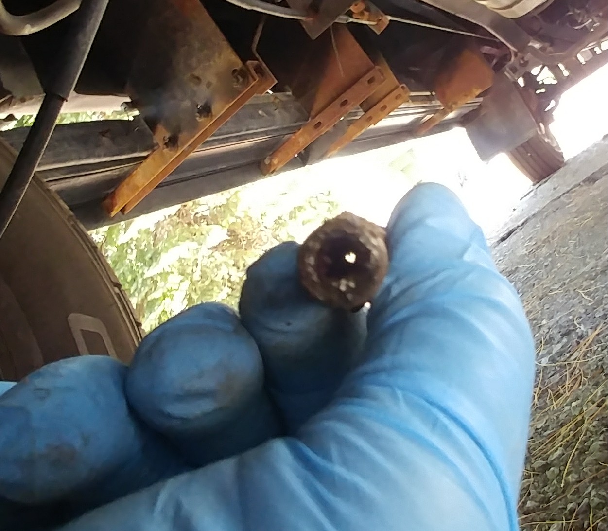

Thanks, Edwin.
2 years and 95% clogged. Hope my heart arteries aren't following suit.
