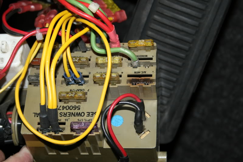

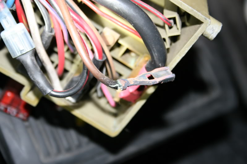

Check the wires under your steering column and take a careful look inside your fuse panel, as the blower motor gets older it draws excessive current and starts to overheat the already undersized wires that feed through the ignition switch, mine melted the bottom cover to the steering column all of the wiring and melted my ignition switch, causing the starter to hang when I tried to start the engine.
This is what happened to mine,
Look here...
https://www.dieseltruckresource.com/...d.php?t=158400
Like Mr thrashingcows stated,
The smoke could also originate from the fuse panel and travel up the steering column like a chimney.
The factory wiring in these trucks is poorly designed and undersized.
If you add any accessory drawing over 1 amp I would use a relay to control it.
Jim
