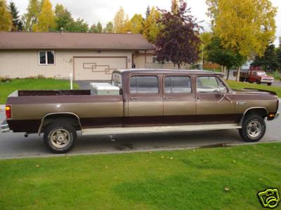

I think this was on Ebay some time back. Just need to add the ex-cab, if you have enough kids or friends............
Old Aug 16, 2009 | 03:46 PM
Ezra's Avatar
Posts: 261
Smile
Originally Posted by ADMOPARMAN
how bout a crew/crew/club/ramburban??
If I didn't want to pull gooseneck thats what I would have built, just like in the pic.
That one is still for sale in Utah.
