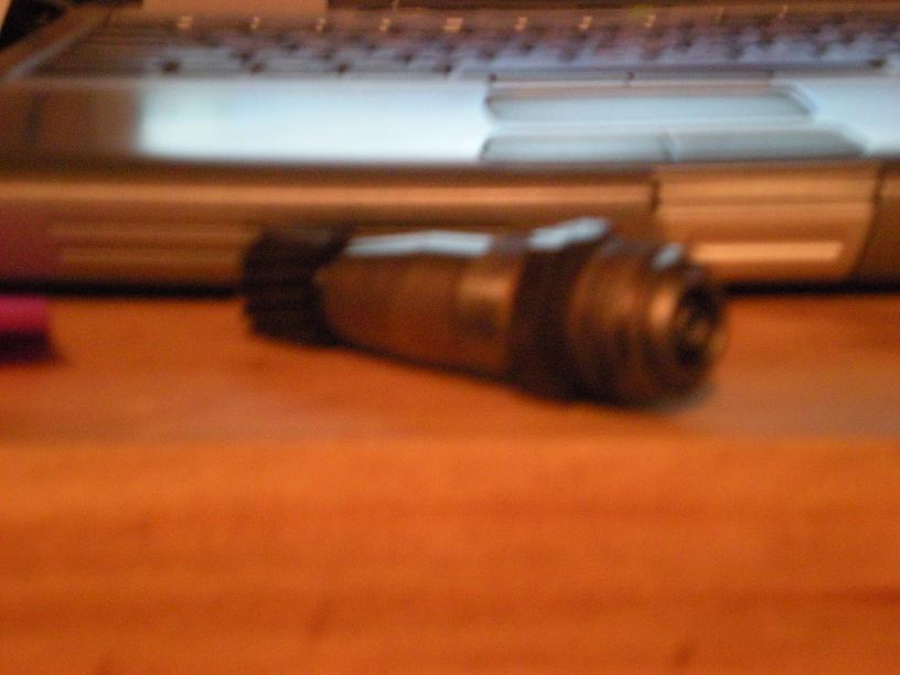

Pics
Can you tell me what part I am missing? I tried putting the VSS on without that shiny part and it sould not go on. I removed the whole thing as you can see by the bit of oil that ran out.

Old Jan 2, 2009 | 04:48 PM
wannadiesel's Avatar
Posts: 22,594
From: New Holland, PA
You have a broken piece (shiny thing) of the old adapter gearbox on the xfer case there. When you pull it off the VSS (or a new adapter gearbox) should thread on. There may be a broken off stub stuck in the drive preventing you from inserting the VSS drive stub all the way, once you extract the broken piece it will all fit together.

Old Jan 2, 2009 | 05:35 PM
93-12Smoke's Avatar
Posts: 1,751
Okay i took the whole piece out and took the shiny part off and this is what I have. With it like this the VSS will not go on.

Old Jan 2, 2009 | 09:13 PM
Posts: 22,594
It looks like there's something stuck in the hole in the middle, hard to tell with the blurry pics. Does your camera have a macro mode?

Old Jan 3, 2009 | 11:31 PM
93-12Smoke's Avatar
Posts: 1,751
Sorry about the pics, to get better ones I will have to go take it out again.
