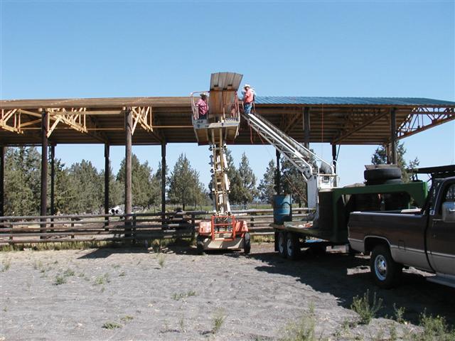

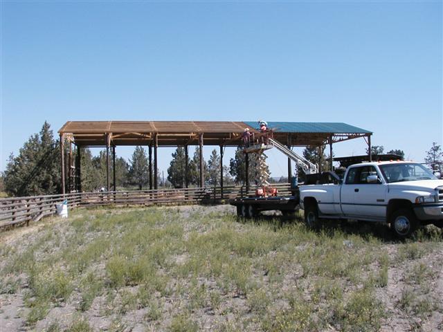

bbrown i have had an old utility manlift that i bolt to my gooseneck for a good 15 years now. i just bolt it to the deck and add water ballast. this was a 20ft plus eve hay barn we built from scratch at my brothers hay farm in central ore. we didn't use a ladder for more than an hour on the whole job. sorry for getting sidetracked.

It just goes to show you - there are very few new ideas - just new people to think them up. That 's what these forums are for!
