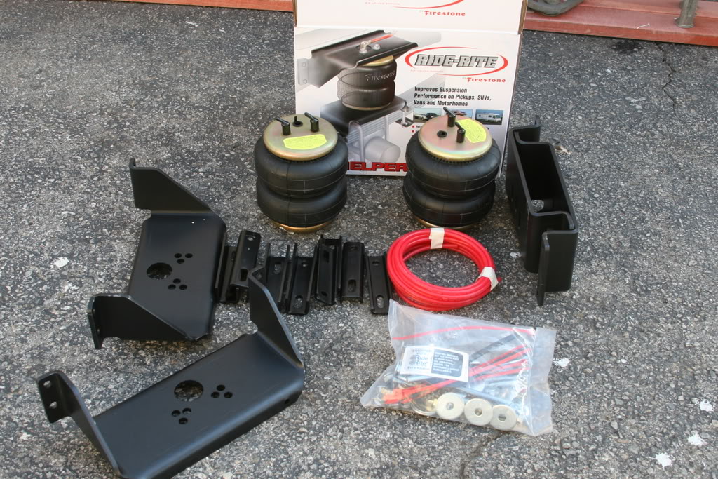

I checked around shops locally for the Air Bags and found prices ranging from $250.00 all the way up to $400.00 for the exact same kit so I found a dealer selling them on E-bay NEW for $234.00, he was in Florida and so I ask where they would ship from and he said they would come out of Ontario Ca. I ask and he arranged so I could pick them up and save the week delay. How nice is that?
Kit I used Firestone Ride-Rite #2071

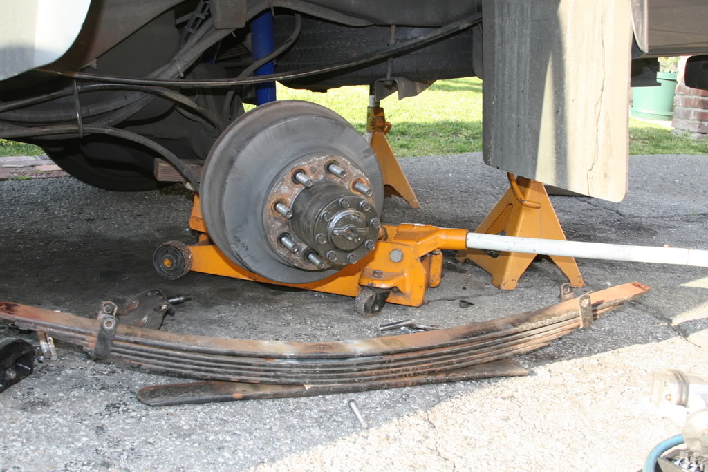

After supporting the frame on jack stands and getting the wheels out of the way I broke down the spring packs.
This is what the stock 7-leaf pack looks like.

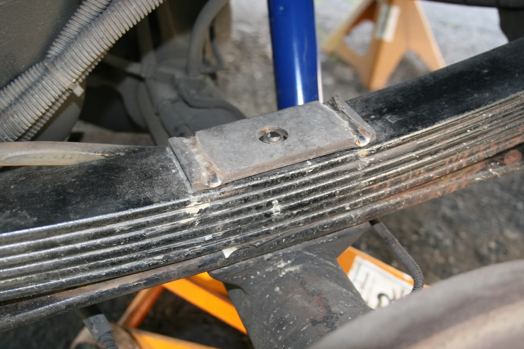

Springs are numbered starting at the main leaf with the bushings as #1, #2, #3, and so on what I did is remove leaf #2 and #3 clean them up and put them back together.

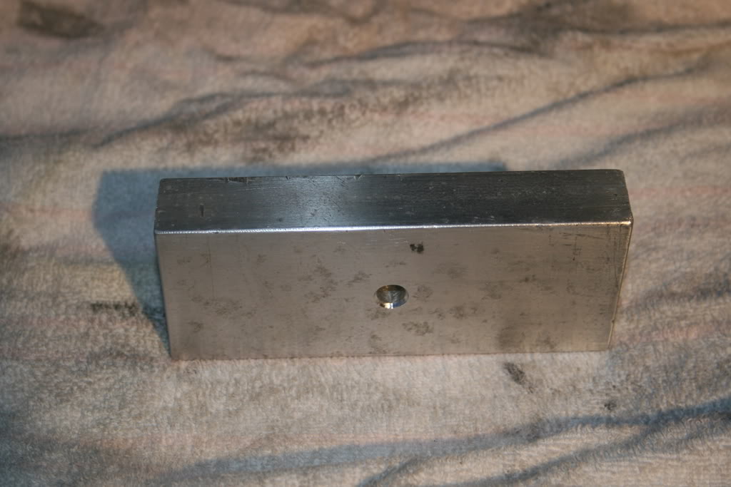

To make up for the thickness of the leaves I removed I cut an aluminum block 2 ½” X 6” X 1” thick and drilled a 3/8 hole in the center for the center bolt that holds them all together.

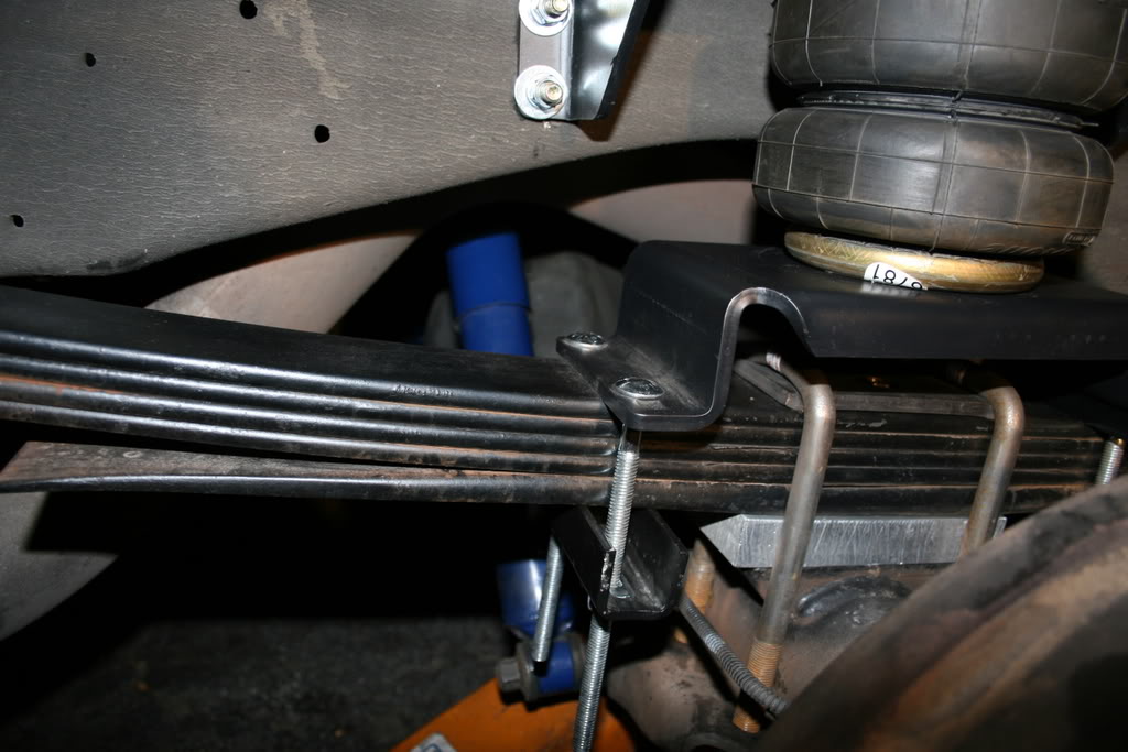

Now with the springs modified I went to work installing the Air Bags, I used the kit designed for my truck however this is quite universal and can be fitted to almost any truck if you wanted to.
With the top brackets installed I then set out to properly align the lower brackets and clamp them to the leaf pack. (You need to shim the bracket for the correct angle)

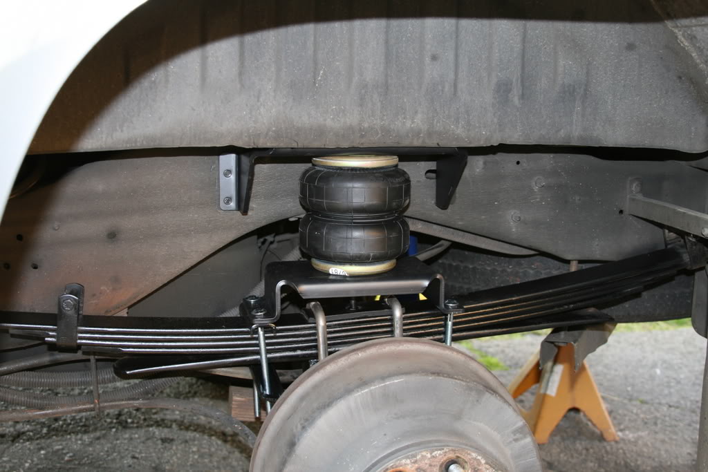

Here is what the completed modification looks like, see the air bag sits directly above the axle. When there is weight on the truck and the bags are inflated the weight of the truck is being carried from the axle to the frame on a cushion of air.

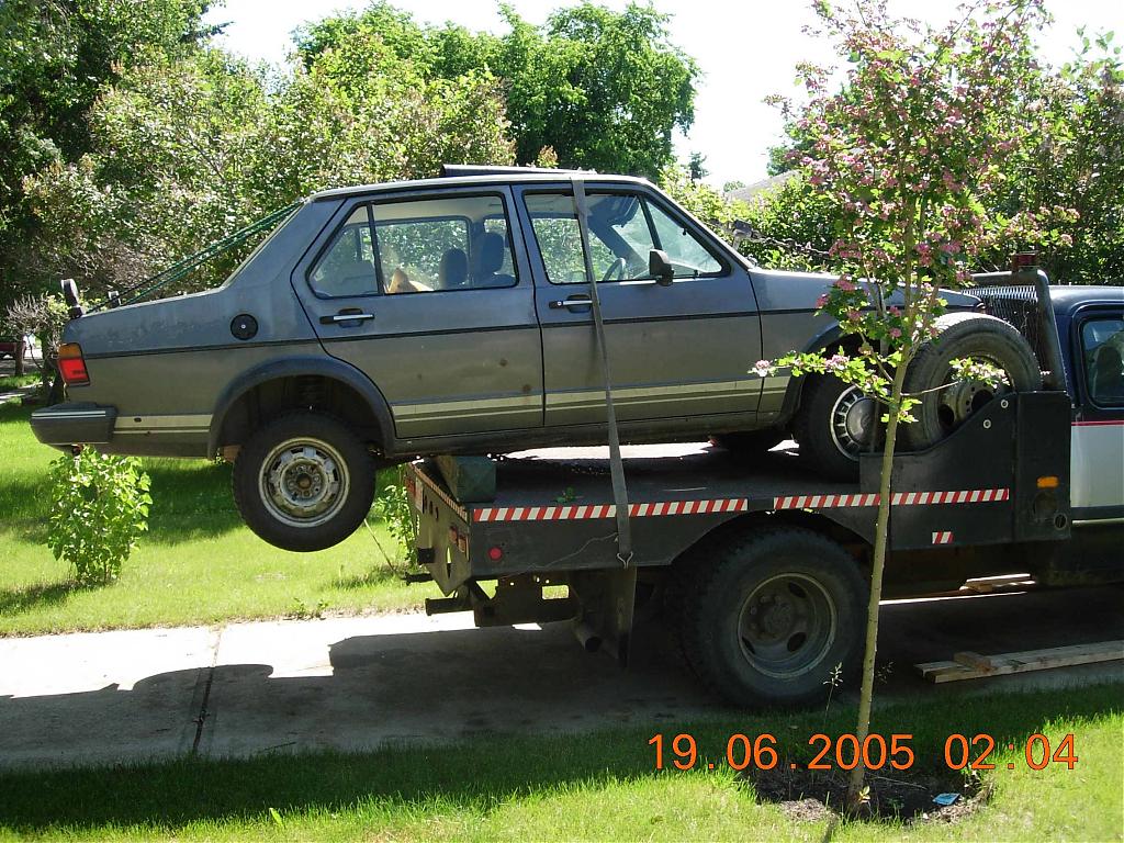

I own a 89 W350 that my uncle purchaced new. He was in the scrap metal business and put one bad rear suspension upgrade on it. when I picked up the truck the rear sus. was not working, needless to say I had to go to the ciropractor the next day. After I found the loose wire and fixed it I pumped up the bag and boy it rode so much nicer. Now I always have it pumped up. Here are som pics. (I hope)
