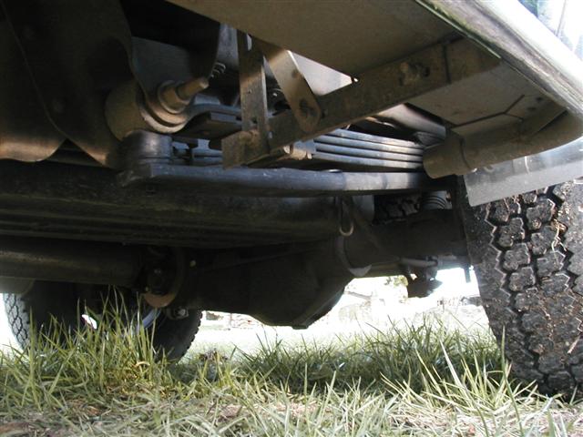

on the subject of axle wrap my dad's 01 dmax with a manual six speed had plenty of axle wrap . with a 5 ton load on the gooseneck the pinion would pop up causing the driveline to bind at the rear u joint . the driveline looked like a worm on hot tin when i filmed it. any way gm left us hanging so i came up with a traction bar/spring. went to local spring shop had them make a spring to replace the overload that was long enough to reach the spring hanger eye . there i installed a rubber snubber. got rid of 90 % of the problem for less than 150 bucks and some time. i am liking what i see with the airbags.

Originally Posted by Jim Lane
That traction bar looks nice..
Looks like a hybrib overload spring/slapper bar. Great idea, but may only be effective under load when the snubber is very near or in contact with the spring eye. Is there any weight on the suspension in that pic?

i set that spring snubber up so it looks like that unloaded. like i said you may notice alittle more spring in the ride , but if you hadn't road in the pickup before you wouldn't ever notice. what would have helped , and i suggested it to the gm expert engineer, was to also have a constant velocity ujoint at the rear of the driveline to take up the extreme angles. they said no way never happen. now gm has a bulleton on it for some models.

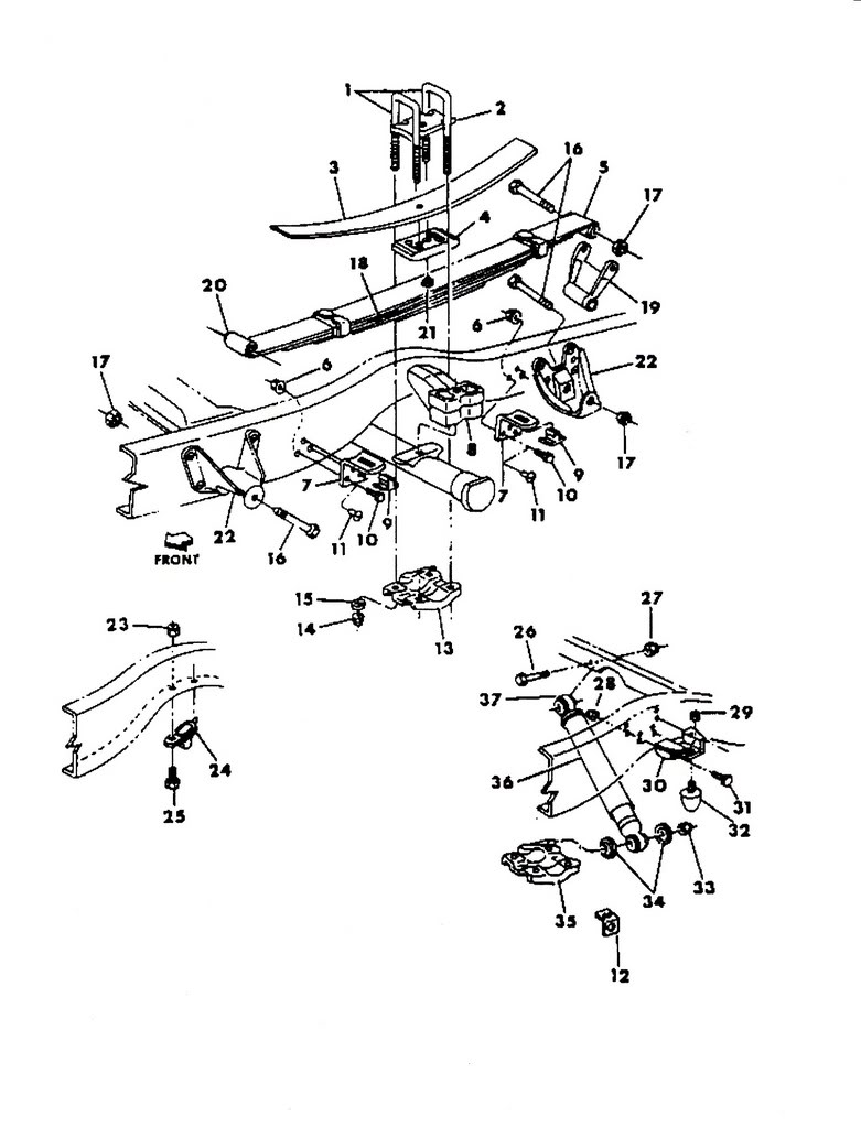

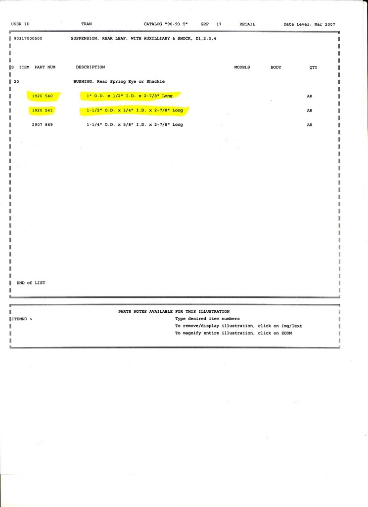

I had checked with Dodge for this same Idea and the springs could probably be made to work however the bushings are different between the ½ ton and the ¾ and 1 ton springs.
The
D-150 have a 1/2" bolt,
D-250, & D-350 have a 3/4” bolt,
D-450 have a 5/8” bolt.
The OD of the bushings are also of different sizes although nothing says you could not find other bushings that would fit.
