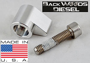

For the lovers of billet
Check out this fancy billet kdp tab. Made to work in all years timing cases, by flipping it either way to accommodate the "step" that's machined in some of the 12valve t-cases.

That sure is sexy but i made mine out of a ground down fender washer that I bent in a vise for about a dollar. Took 15 mins or so. That one is pretty cool though.
It is cool, isn't it, lol!! Makes me want to redo mine, just to see it shine all "bling".
However, the thought of the timing cover covering up that "bling", along with the unnecessary work, made me say NOT!
