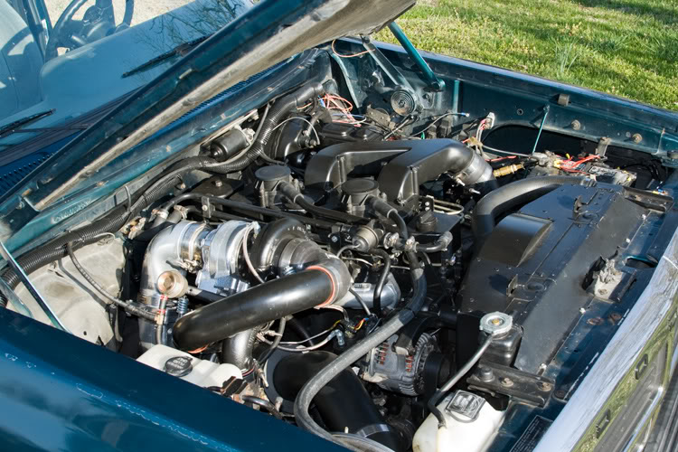

Thanks for the kind words folks.
I've always kept the engine bay clean. Not spotless, but clean enough that reaching for something, you don't draw back and find oily dirt on your elbow.
Most every time I've pulled a large component out, I'll wash it and paint it if it's beat-up OEM. It's actually easy to keep these engines clean IMO.
The short block is OEM and has just shy of a quarter million miles on it. The removed working just fine head was replaced with a new ported head maybe 3000 miles ago.
The engine has seen three head-gaskets now. The OEM unit was replaced mainly due to an antifreeze leak right there under the thermostat housing at about 240K. Head-gasket number two failed not long afterward due to a freak instance of head-stud nuts splitting. Head-gasket number three is doing just fine seeing the occasional 65 psig plus boost.

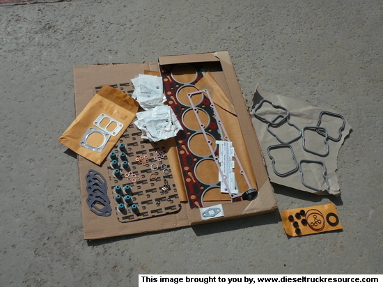

For reference:$213 gets you this kit from cummins
