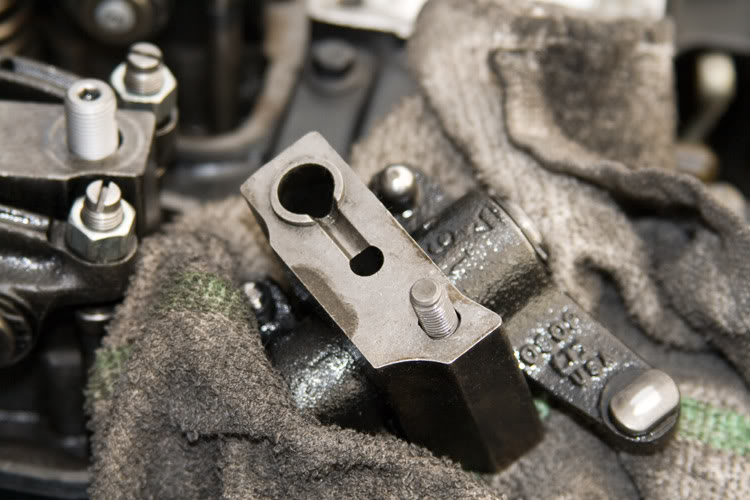

- Loosen all the valve-lash adjustment jamb-nuts and screws. Go ahead and loosen them to the point any valve-spring pressure is relieved.
NOTE: Loosen the adjustment screws so that one can move the rocker-levers say . . . about a 1/16 of an inch. Make them all pretty close in measurement. It doesn't have to be rocket science like. You'll understand why when we go to putting it all back together.
- Loosen and remove all the cylinder head bolts starting in the center, and work your way out in a circular pattern. Here's a diagram as to how I'm talking about . . .
- Completely loosen the remaining smaller bolts that hold the rocker-arm pedestals to the head.
I've always kept any removed parts segregated so that they will go back where they came. In this case, I take some quart size sandwich bags and number them with a permanent marker. 1, 2, 3, etc.
- Lift and remove the individual rocker-arm pedestal assemblies, complete with the small bolts and place the assemblies in the sandwich bags.
In keeping with the above segregation, I take a piece of cardboard, punch six pairs of holes in it, in a line. I number each pair; 1, 2, 3, etc. I also note each line of six holes as; Intake, and the other Exhaust.
- Now remove the valve push-rods from each cylinder and place them in the appropriate hole of the cardboard.
The point of all the bagging is that with time and normal use, the valve-train components have worn into one another. Inadvertently swapping the push-rods around for example, may very well result in sudden, greatly exaggerated wear and early failure. If you've ever had to repair a bicycle or motorcycle chain, you know a new chain will not last on used sprockets. Not long at all.

NOTE: Remember where we loosened the adjustment screws so the rockers would move about 1/16 of an inch? When reinstalling the rocker pedestal assemblies, if you find that things won't sit and nest to the head seemingly because a push-rod is too tall, that push-rod is NOT seated in it's lifter. The push-rod is actually sitting off to the side of it's lifter. You must reposition the push-rod so it's nested into the rod socket of the lifter. Don't, things WILL break catastrophically!
Remember all the oily goo in the head-bolt holes under the rockers? On it's way to the rockers and valve stems, the lubricating engine oil must first come up through the block, and by way of a passage in the head-gasket, the oil flows over to the long head-bolt where the oil flows up through the head.
The oil then flows through that groove in the base of the pedestal over to a passageway through the pedestal and to the rocker bearings, etc.
Kewl!
