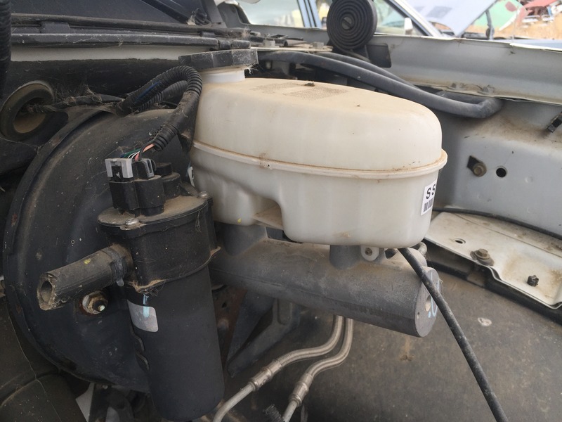

The Avalanche unit seems like a vacuum boosted model? The 95 dodge was too
The Ford unit

ford is a hydroboost with a huge master cylinder. I don't know what the ford uses for lines or what the sensor/switch on the bottom is.
I got mine from a pre 95 Chevy astro van and bought a new master cylinder for a 94 Chevy k3500. the mount is a direct bolt on. I did change the pushrod to adjust the pedal to my liking.

Hey Ashley....seems like the Ford is the only Hydroboost set-up. You could run it as you have it, or do some research and see if another MC would work...not sure if that tall unit would clear the underside of the hood....
