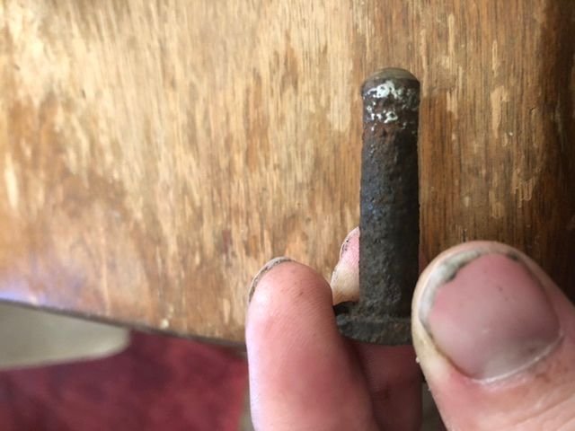

The worst of the corrosion is where it was in contact with the rubber boot.
It’s hard to get a decent picture but there’s a fair amount of pitting. Maybe I’m worried about something that’s not worth worrying about. The old lady certainly wouldn’t complain if I didn’t have to buy new ones.

That looks usable...I'd clean it up on a wire wheel, coat it with a little silicone grease and re-use it......Ben

Was that thing under water at some point or do you live somewhere they use a very corrosive salt to de-ice the roads? That's the worst I've seen. The main pain point is the tiny little ears that keep engaged with the Brake shoe. Those are the parts covered with your fingers in the pic. The pits on the shaft will let water into the brake cylinder but that could be sealed if you can't fine new ones. It might be worth the trip to get new ones just for peace of mind.
