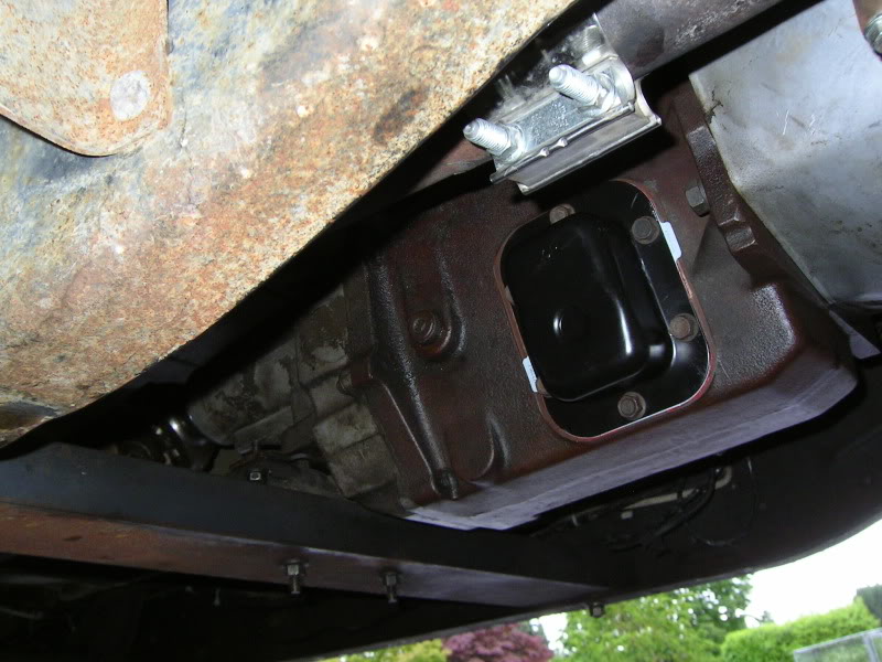

Well I got some advice form a couple board members and decided to change the fluid and install a filter kit from Geno's.
I got my Syntorq from, www.blumenthalmfg.com for 5 quarts it cost me $59, not a bad price!!
So I removed both PTO covers and did the complete clean out, wiped the inside of the case, sides and bottom until it was as clean as I could get it. Then installed the filter kit on the pass. side and refilled with the new syntorq.
I noticed it shifts a little smoother, and it doesn't grumble quite as much. But before I did this I noticed that it didn't grumble as much in the mornings when the fluid was cool, once it warmed up the grumbling became much worse. So hopefully it will help, but at a minimum I at least know have the peace of mind knowing the condition of the fluid in the tranny.
Another thing that I noticed when I pulled the PTO covers was that both the side covers had a fair amount of scratches and gouges on the inside. I think this tranny might have blown before. So who knows how old the tranny rebuild is but my input shaft cover seal is weeping a bit.
