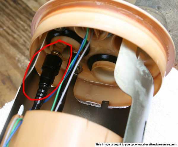

It seems like I recall the actual single part you're talking about amounts to a plastic plug, that plugs into the top of the fuel (pump)/sending fuel-sump assembly.
Which tit broke? Supply (outflow)? Or Return (inflow)?
Check out my thread about butchering the thing for pics and getting an idea about how you could make a new connection and still have it work as intended. Shouldn't be too big a deal.
HERE: https://www.dieseltruckresource.com/...d.php?t=151190
I'm not suggesting you need to go with big lines, the point is look at how I replaced the smaller plumbing, and made it bigger using this and that. You can put a stopper in somewhere and use it to hold new bulk-head fittings.

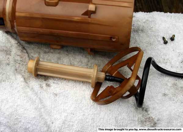

That spare bung (as is shown in the above image) would be the ticket for a simple replacement supply bulk-head fitting.
A while back, I replaced the stock/OEM diaphragm type lift-pump with a low-pressure piston style of lift-pump: https://www.dieseltruckresource.com/...ad.php?t=93722
I later replaced that with a 2nd gen CTD piston style high-pressure lift-pump: https://www.dieseltruckresource.com/...d.php?t=176472
Since then I've removed it all and installed an electric Walbro 392 lift-pump back at the tank (externally).
See light-colored long cylindrical part? . . .
That's actually a spacer/filler to replace an electric fuel pump normally used in a gasser application. With finding the right diesel rated application of that pump (the body style appears to be quite common stock/OEM and aftermarket models), one can put the pump there.
