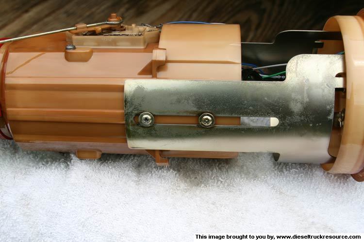

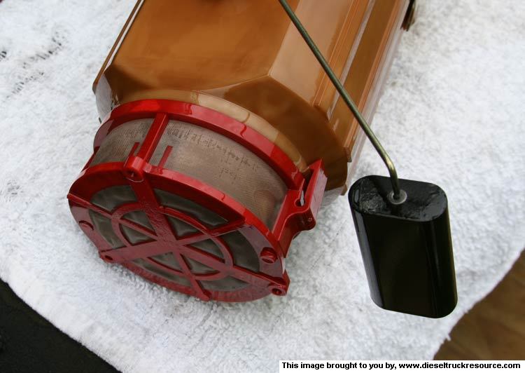

OK, the Dodge/OEM fuel pick-up assembly includes the fuel level sender.
OK so what does it do?
Not only do we want to pick-up fuel. We would really like a continuous supply at that. We could provide the tank a sump for the pick-up but it would be at the expense of ground clearance in my mind. If I were an automobile manufacturer, I'd want the most adaptable parts so as to keep inventory at a minimum.
Designed as such, the OEM assembly does the job elegantly. Its design allows the actual point of fuel pick-up to be in a large range of depth pending the tank in use, its sagging with the weight of the fuel as the truck moves about, etc. The OEM pick-up assembly appears capable of stretching or compressing to the tune of about 2 1/2". It's accomplished by built in sliding mounts between the top and bottom half of the assembly. ~

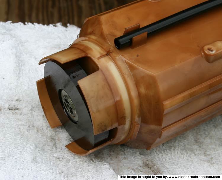

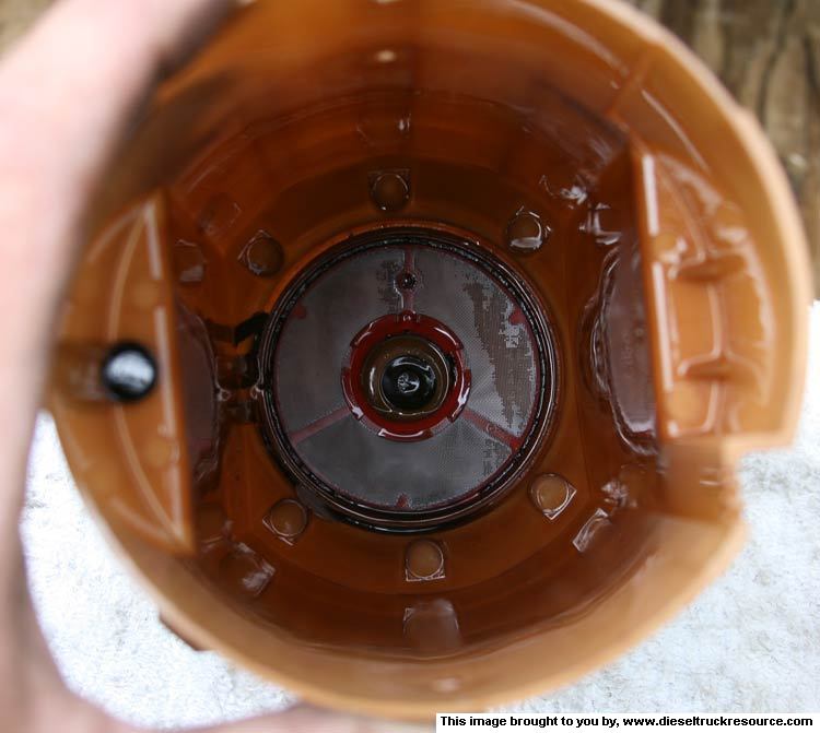

The fuel is normally collected at the very bottom of the assembly through the primary fuel screen. ~
The fuel is then drawn through the center of the bottom of the lower half of the pick-up assembly. This lower half is called the reservoir. ~
The fuel is drawn through the above (center red ring) by what I'm gonna call the pick-up pipe (this is actually where an electric fuel-pump would go in a different application). It is in turn connected to the top half of the pick-up assembly by a spring-shaped plastic tube. The spring shape accommodates the stretching and compressing of the complete assembly. It's held in the reservoir by the basket looking thing. ~

So what keeps the returned fuel from running out the bottom of the reservoir?

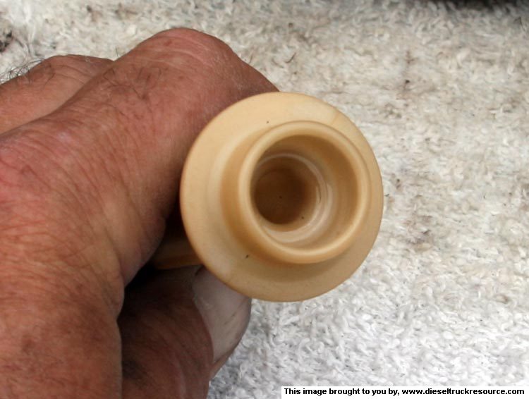

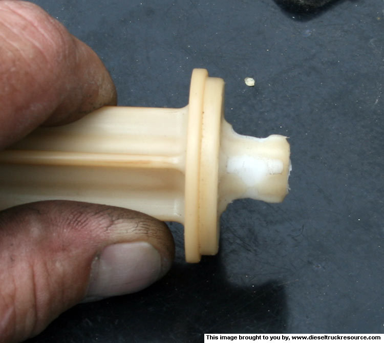

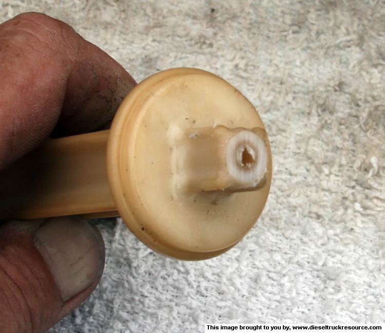

A Float Valve located just inside the primary fuel screen.
The way I figure it works is:
- When the primary screen is immersed in fuel be it a static fuel level, or a passing wave of fuel, the float lifts the valve allowing fuel from the bottom of the tank to be drawn into the fuel pick-up pipe for delivery to the engine.
- Should the the fuel level be so low as to expose the primary screen to air, the float drops, switching the valve so as to draw fuel from the reservoir that's being filled with return fuel. ~
Any reservoir overflow is conducted back to the tank through the tube on the side of the reservoir as seen above.

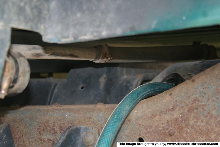

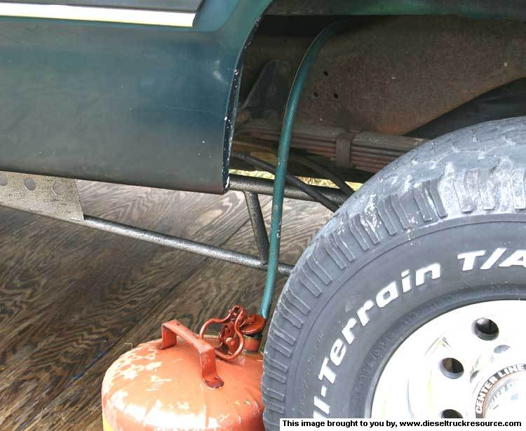

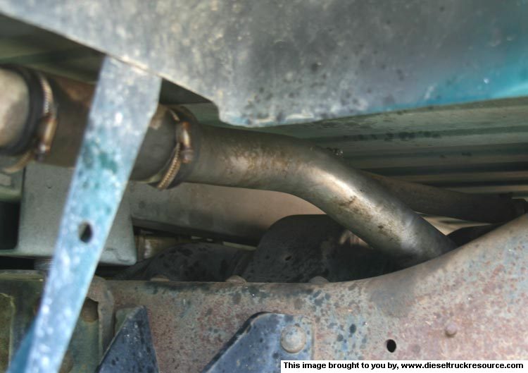

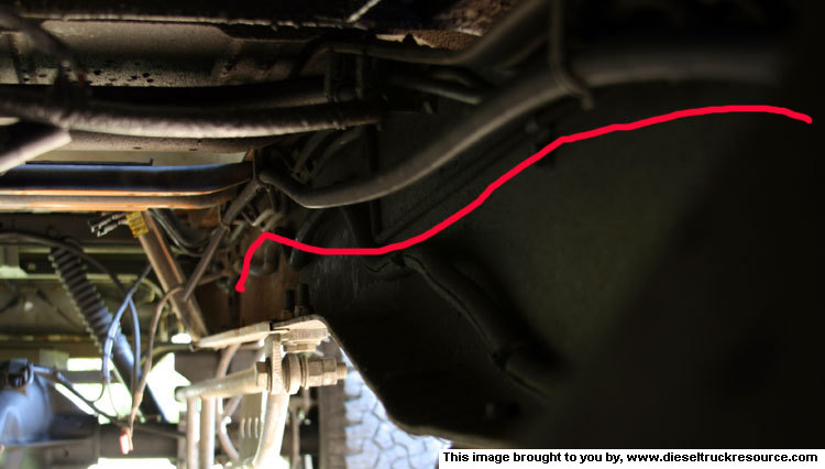

- Reach forward of the rear drivers wheel well and remove the tank fill pipe. I loosened the one screw clamp, removed the pipe from the hose, and then pulled it out of the tank. Be sure to wipe away any grit before doing this. ~
- Having removed the fill pipe, insert the appropriate length of hose to siphon any fuel remaining in the tank. ~
- Be sure to collect the fuel in a container designed and properly labeled. Be careful siphoning and promptly clean up any fuel spills. Plug the hole left in the tank with a clean paper towel.
- Disconnect the fill vent tube from the hose going to the top of the tank. ~

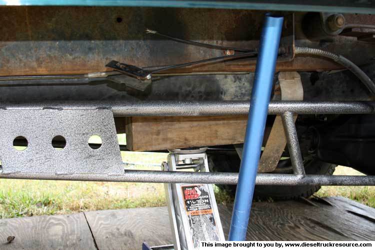

- I used an aluminum floor jack with a 12" piece of 4x4 to support the center of the empty fuel tank. Press up with the jack initially to aid in removing the bolts securing the tank support straps. Having removed the bolts, lower the tank three or four inches so you can reach through and disconnect the fuel supply and return tubes, as well as the fuel level sender connector. (Yes, I have to fix my parking brake cable clamp). ~
- Now safely lower the fuel tank to the ground, pull it out from under the truck, step back and here's what we have. ~
I just left it there next to the truck and placing a clean towel on the far end, used that as a work bench.

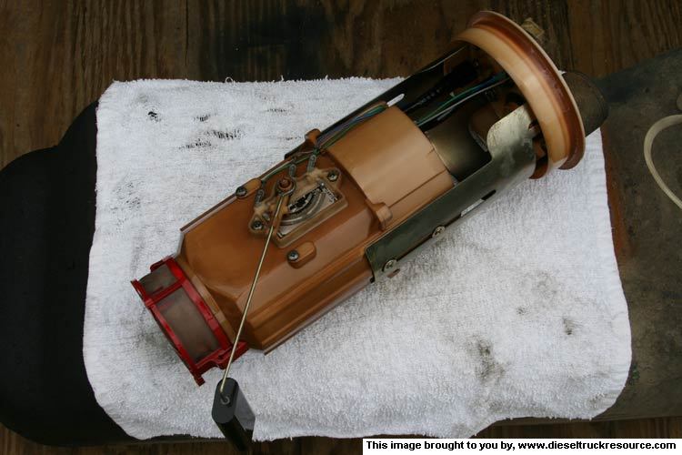

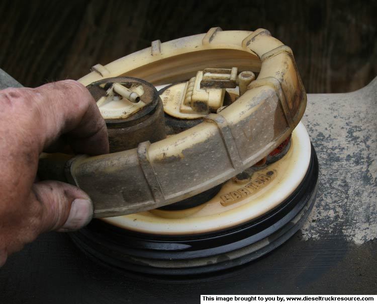

- Now to start, we need to sweep away any mud and dirt from the top of the fuel pick-up assembly.
- Having done so, we can now remove the collar that secures the assembly to the tank. Mine was surprisingly loose. ~
- With that, we can now lift the assembly from the tank. Be sure to tilt the assembly toward the front of the tank as you finish removing it from the tank so as to clear the fuel level sender float. Set the assembly on the front of the tank (work bench). ~

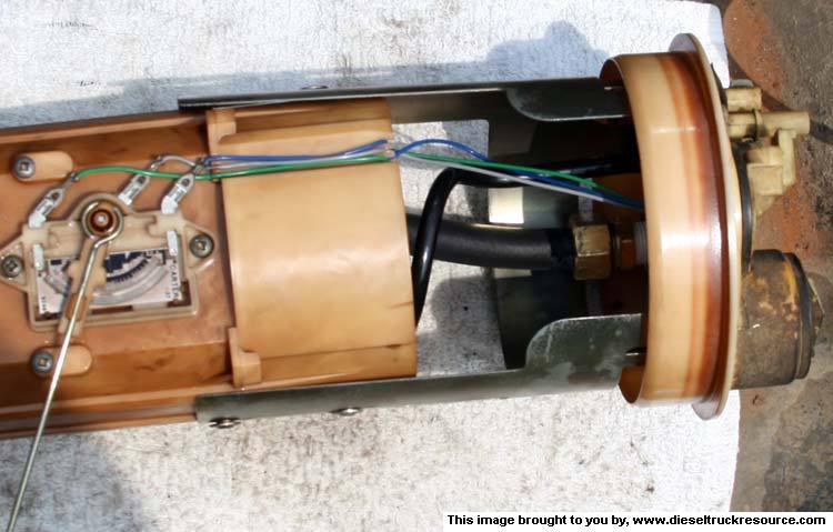

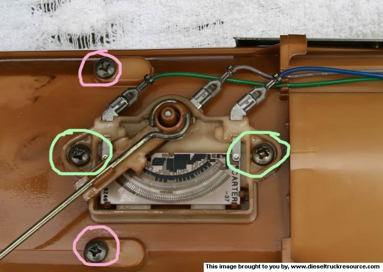

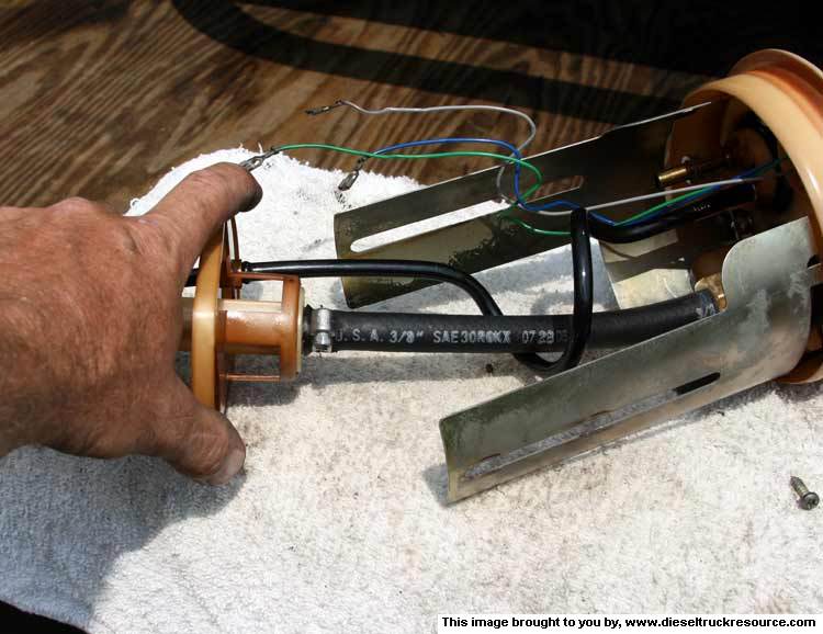

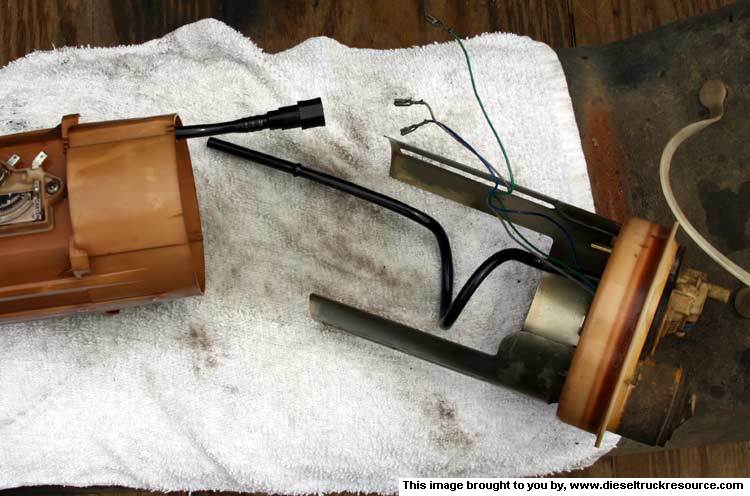

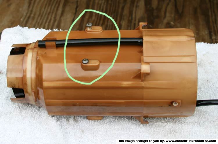

- Now before we brake the blame thing, let's remove the Fuel level Sender and its Float assembly. Do so by first removing the three wires using needle nose pliers. Grab the connectors by its shank and not by the wire. Mine were on there pretty good so be careful.
-Now remove the two screws circled in green and place the sender assembly elsewhere out of harms way. ~

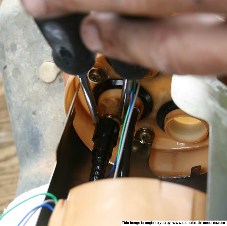

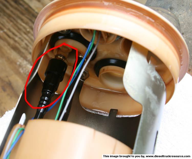

Now, looking up inside the top we can see where the fuel supply tube from the pick-up pipe connects. ~
- My fat fingers wouldn't reach in there so I had to use a couple of screw drivers to work the connector tabs to get it loose. ~

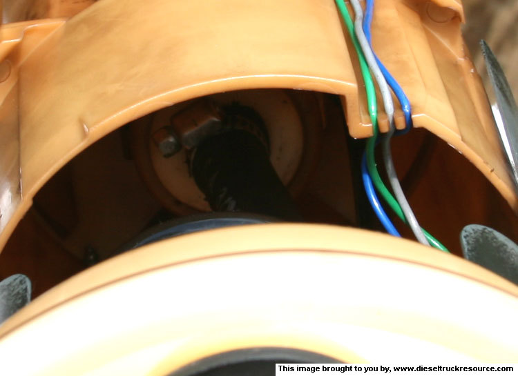

- You'll see that on the side of the reservoir, there are two brackets with slots that connect to the top of the assembly. There are two screws on one side, and a single screw on the other. Remove those. ~
- At this point, you should be able to separate the top from the reservoir. ~

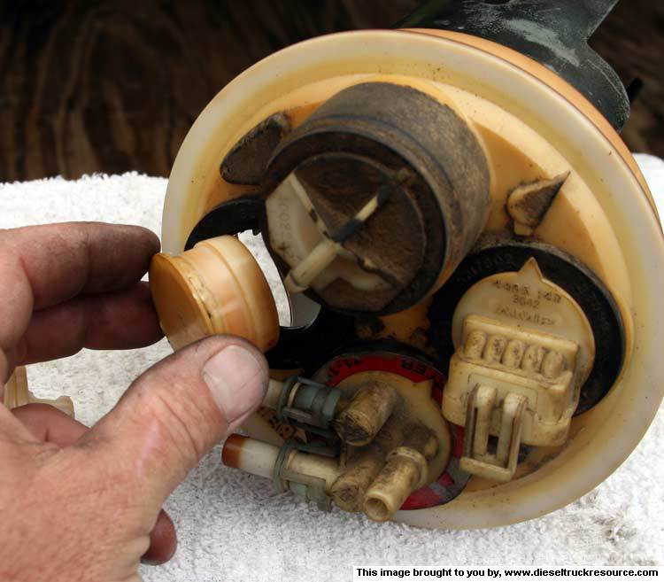

- OK, now go back to where the fuel level sender was mounted to the reservoir and remove the two screws circled in pink. ~
- Roll the reservoir over to the opposite side and remove the two screws from there. ~

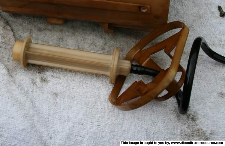

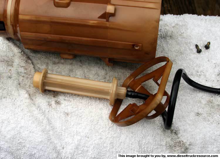

- Now we can withdraw the fuel pick-up pipe and its holder. ~

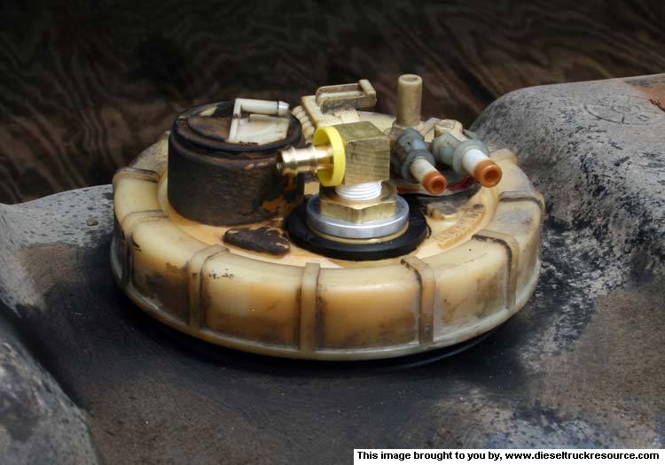

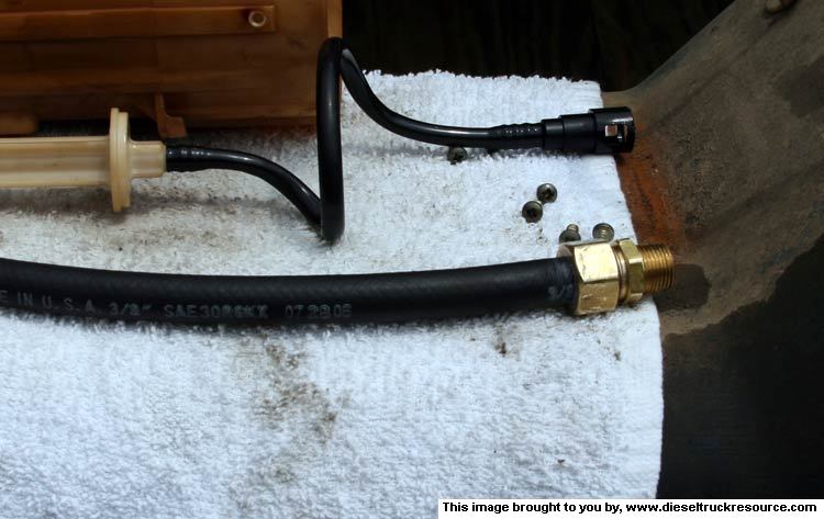

Now let's see about adapting the big line to it.

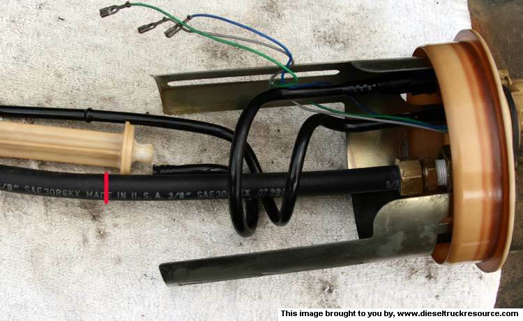

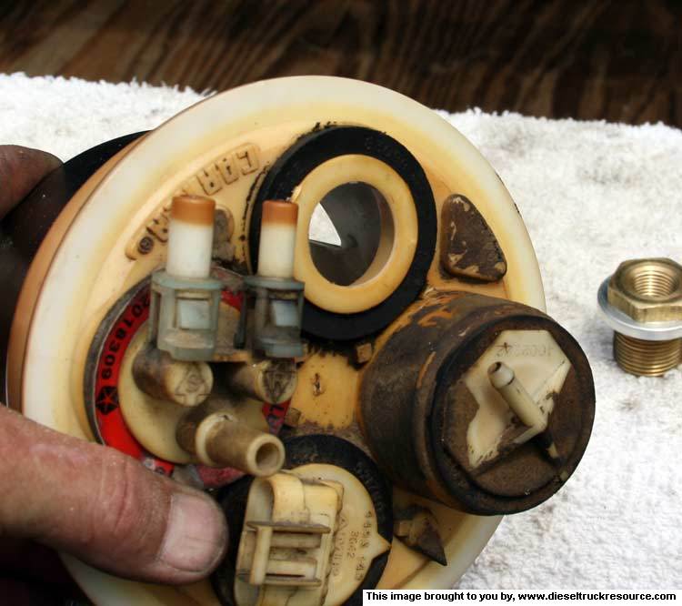

If you go back and look at the top of the fuel pick-up assembly, you'll notice what I call the spare bung. It's nothing more than a plastic plug sticking into a rubber grommeted hole in the top assembly. We can mount the new big line pick-up bulkhead fitting there. ~
We can run the tube from there down to the pick-up pipe.

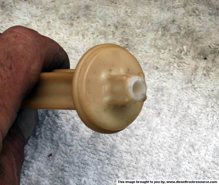

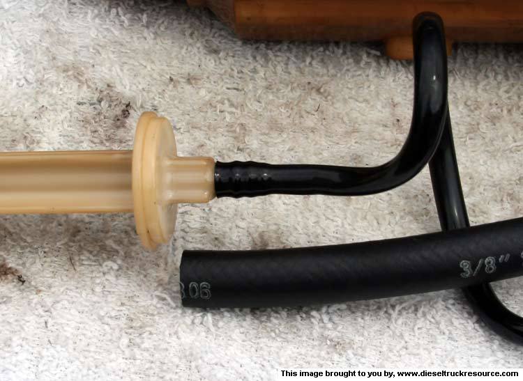

But wait! What about the springy-shaped OEM fuel pick-up tube? How ca we accomplish that function as the big line pick-up uses fairly ridged tubing? ~
- To get around that, I swapped the ridged tubing with some standard fiber reinforced 3/8" ID rubber fuel hose. Fits like it should using the same inner sleeve, ferrule, and compression nut. ~
Granted, the total assembly is capable of two or so inches of expansion and contraction, but based on the wear marks in my mess, I only need about 1/2" or so of play. The rubber hose will work fine.

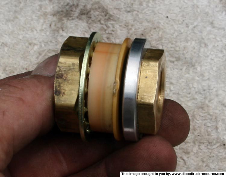

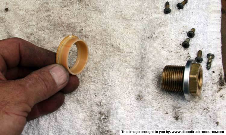

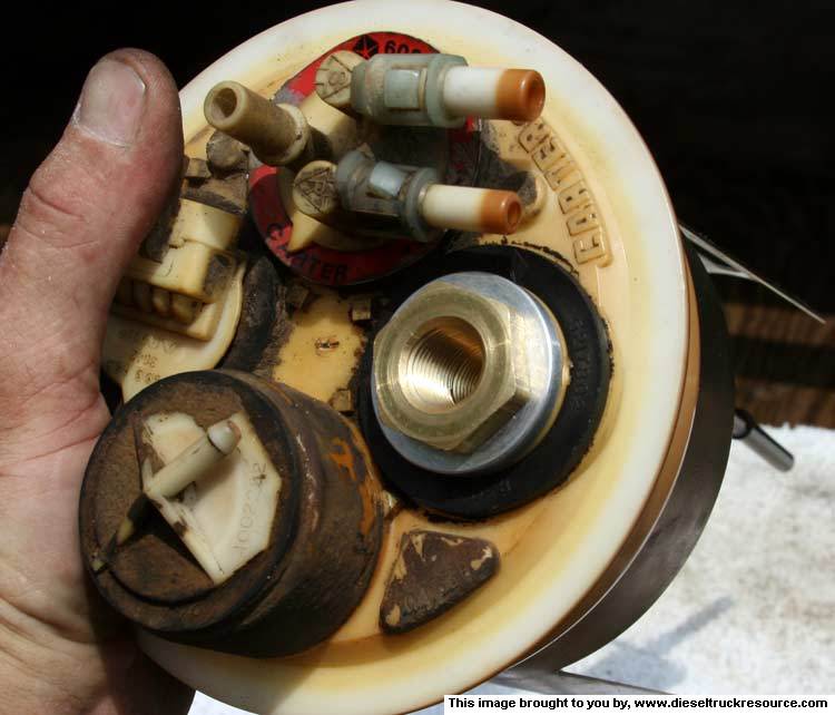

Let's install the new bulkhead fitting.
- Start by removing the spare bung plug. ~
- We need to modify it to the extent that it has a hole in its center large enough to accommodate the bulkhead fittings diameter, and it has to be shortened enough to allow the lock nut to be installed on the bulkhead fitting when it's installed in the top assembly. ~
- You'll need to remove enough of the length of the plug so it can fit the bulkhead fitting and have the nut go on as it should. ~
- Once you get it whittled right, you'll be able to put the bung plug back into the top assembly. ~

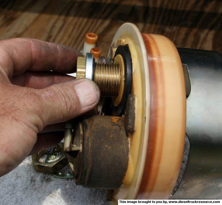

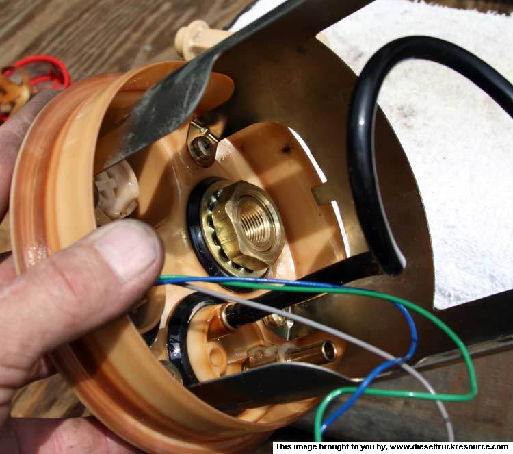

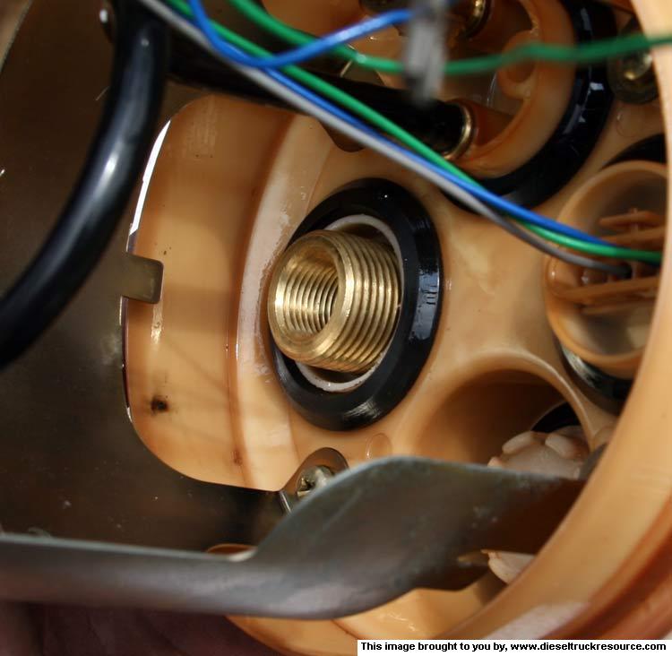

- Now slip the threaded portion of the bulkhead fitting through the top. ~
If you shortened the bung plug enough, you should have ample threads showing on the bottom side. ~
That way you can install the lock-washer and nut for an effective seal when snugged-up. ~
Speaking of seals, the bulkhead fitting itself has a rubber O-ring under its flange. Be sure to drill the hole in the bung plug small enough that the rubber grommet can seal against it. ~
- To complete the install of the new big line pick-up bulkhead fitting, I used Teflon tape to seal the threads of the new flexible pick-up tube on the bottom, and the 90* to AN6 adapter on the top. ~
- Now set the top assembly to the side for a moment.
We need to adapt the OEM fuel pick-up pipe to the new flexible 3/8" hose. ~
- I started by cutting off the OEM tube right where it wraps the hose-barb. Ooh! That's a little hole in there! ~
- To make that pipes inner diameter bigger so as to more closely match the big line, using my drill index, I enlarged the passage by twisting gradually larger drill bits in there by hand. I say by hand as if you break this with an out of control power drill, you're on your own. ~
One thing you'll note is that the passage in the fuel pick-up pipe swage's out to a larger hole at the actual fuel pick-up end. Don't even try to make the passage that big as the hose end will be much too thin. Just open it up to about 1/4" (+/-). ~
- So now we need to fix the pick-up pipe so it'll accept the flexible rubber hose securely. Adjacent to where you cut off the OEM hose barb, you'll notice the remaining stump had four ridges along the side. Using a file, I cut those so that in the end, they resemble the ridge around the end of a regular tube that would connect to hose of such. This way, when we slip on the hose with a small standard hose clamp, the remaining "barbs" will lock things in place. NOTE: Be sure to make that section where the clamp would sit fairly round and true as that will be the seal between the pick-up pipe and hose. Suck air there and you'll cuss me. ~
- Now we must cut the new flexible pick-up hose so that it mimics the OEM piece in its spring action. I simply looked at the reservoirs sliding mounts of the complete assembly to see how much movement must be accommodated. In my case it appears about 1/2". So I temporarily placed the OEM pick-up tube back in the top and positioned the pick-up pipe so it would be in its normal position. That had the new hose run right beside things so I could eye-ball where to cut. ~
- Having done so, we can now connect the new pick-up tube to the pick-up pipe. I used a standard stainless steel worm drive hose clamp. Don't forget to slip on the pick-up pipe basket mount thing first. ~
We can start to put things back together now. It's pretty much the reverse of disassembly.
- Start by placing the pick-up pipe and its basket back in the reservoir. Look at the sliding mounts to see which way it should go. Two screws on one side, one screw on the other. The return line tube goes in the hole to one side of the pick-up pipe basket.
If you cut your new flexible hose right, it should present with a small hump off to one side with the whole assembly in its maximum extended position. When you compress the whole assembly, the hose should flex off to the side as things move.
Here you can see the new tube in its installed position. You can just make out the tube kicking off to the side. ~
- Reinstall the four screws that hold the pick-up pipe basket in place. The screws DO NOT thread into the basket. They simply stick out just above the basket so as to not allow the basket to lift out.
- Reinstall the fuel level sender assembly with the two remaining screws.
- Reconnect the electrical connectors securing the wires in the little slot things. (Make sure the wires aren't wrapped around the tubes).

- Make sure the truck is still safe to crawl under.
- Ain't nothing to it. My heap is as such that there are mounts for all the bed wiring harness, fuel and brake lines. There are even extra mounting holes that conveniently fit the new big fuel line. I used those. ~
- Reinstall the fuel tank again using the floor jack and block of wood leaving a little space at the top so you can reconnect the fuel lines, etc.
