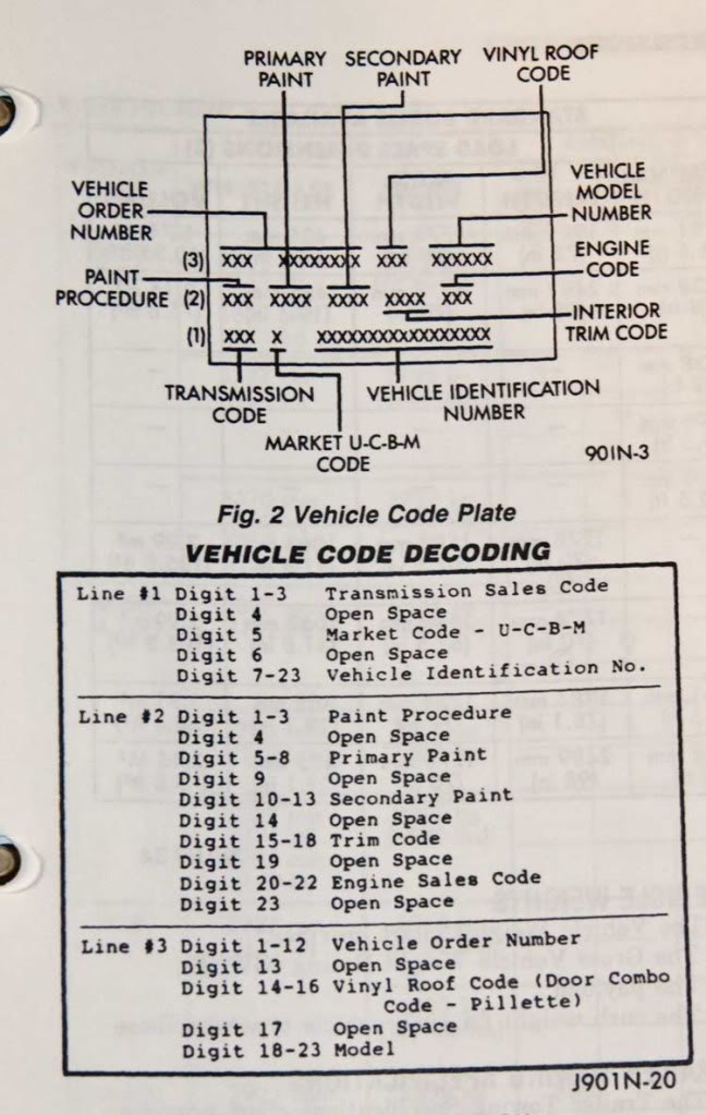

This is from the 1993 FSM and is consistent with that shown in the 1990-1993 Dodge Truck Parts Catalog (Aug '92). ~

We still need the code deciphered, QAC and PAC , so its the AC that counts
