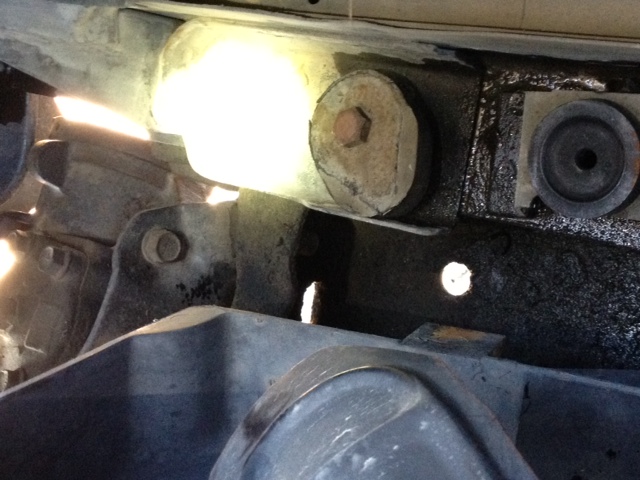

There are two of these mounts on each side of the lower radiator mounts... What are they????? They are flopping around in there and where can I get them?

well it's either 1 or the other first 1 look's like core support bolt's ? and other is radatior cushion's the core support bolt's can be tightened from under the truck look up in the middle of the first cross member

This is the rubber between the rad support and frame:
http://www.dodgeconnection.com/catal...70/3091657.htm
I have not been able to find the rubber/bolt assembly you have shown. Chrysler may have it but i hate talking to stealerships.
Old Jun 4, 2012 | 07:28 PM
Those oblong ones are on the top...I think to be able to adjust the "in/out" position of the rad support. As the other pics show there is a round rubber bushing between the rad support and frame rails.
Probably just have to go with a universal round rubber bushing. I'm pretty sure that is what I had on my rad support. I have some originals in bad shape as well and the ones off the rad support in the crew were nothing like those.

try energy suspensions may have something in poly

I hope I can to the bottom side and maby tighten them down. There is at least a 1/4 inch of slop in them..

Buy a 6-pack for your Air Conditioning buddy and ask him for a couple or four of the hard-rubber pucks that are supposed to be installed under the Trane gas-packs and such. Cut and drill to fit.

I saw this part number in a earlier thread..
5-4101G -- Energy Suspension
Its a cab mounting kit. Does anyone know if the radiator core support bushings are in this kit?

The spectra radiator I bought came with those rubber bushings. I'm sure you could make them though, just a thought.
