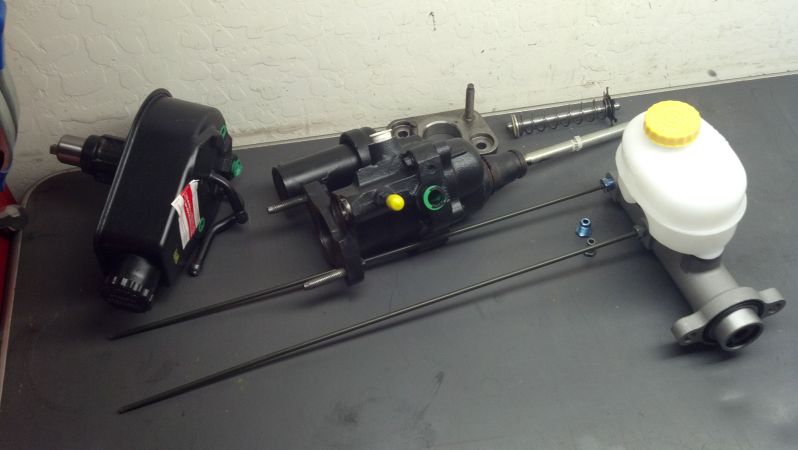

hydroboost kit!!

What makes hydroboost better?

No more big woosh of air when you step on the brakes and it will actually stop.

Originally Posted by wheelieking71
hydroboost kit!!
Where did you get your hydroboost kit from?

the power steering pump with can, hydroboost unit, and mastercylinder are all just reman parts from Orielly auto parts. (actually the master cylinder is new) application was 99' Dodge Ram 2500. be aware there is a core for the pump, and the hydroboost unit. and, be warned that the hydroboost does not come with the plunger/spring/spring retainer/mastercylinder adapter. i cheated on the cores and sent back an old hydroboost unit from a furd stupiddooty i have had laying around for years, and a chevy steering pump LOL. they will get over it LOL.

I'm looking to put a 2nd gen master cylinder on my truck, let me know if your 1st gen brake lines screw right into the 99 master,
can already answer that. NO, they do not. the 99' master uses metric "bubble flare" lines. and corresponding 10mm, and 12mm nuts. the metric nuts fit the 91.5' 3/16 line just fine. so i bought some nuts, and a bubble flare tool. problem solved.
