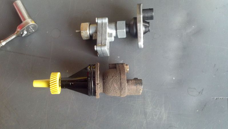

and after banging my head off the wall for a week trying to figure out how im gonna come up with 8volts for my VSS. i had a realization today! you know those times when the solution to a problem is so obvious you over-look it? well i think this may be one of those times. here is why:
that is a 91.5' speed sensor, sitting behind a 93' speed sensor. the 91.5' obviously converts an old-school cable type speedo drive to electric. the 93' sure does look like an old-school cable type drive on the gear end. DUH, get an old-school cable type drive from a 727 and run the 91.5' sensor! sometimes im an idiot! LOL

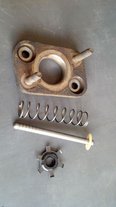

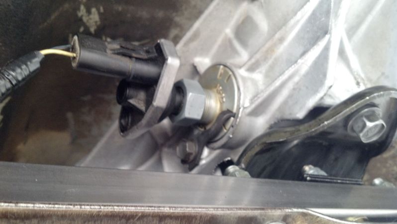

so, today has been a GOOD day! first off, got up nice and early and went junk-yarding. first thing i was looking for was a mechanical speed drive for a 518. found one under an 88' ramcharger! scored it for $5! and here it is installed in big-whiteys 518:
and, yes, the speedo now works perfectly! love easy fixes. according to my GPS it is reading about 1-2 ticks fast. when the speedo reads 65mph, the GPS reads 64. close enough for me!!!
also, last weekend i bought the parts to do a hydroboost conversion on my brakes as i have been having issues with them from day-1! i have been through 2 vacuum boosters, and 4 (yes 4) mastercylinders. and spent countless hours bleeding. but i cannot fix the problem. i am now thinking it may be the proportioning valve. but i have never had one go bad, so i dont know how the truck would react if it was bad. its just a guess. we will see how it acts after the hydroboost conversion. anyways, i learned that when you buy a reman hydroboost unit it does not come with the plunger/spring/spring-retainer/master cylinder adapter. you are supposed to use your old parts. well, i had no old parts. you cant buy those parts from the dealer. they are part of the $741 hydroboost assembly! and there just are not any Cummins trucks in the junk yards around here. nothing rusts, so unless they get wrecked they tend to last forever or go back east. well today was my lucky day!!!! i found a smashed 98' with hydroboost! it was hit so hard in the front that the hydroboost unit was less than arms reach while standing in front of the truck. and! somebody had already taken the mastercylinder, and removed the nuts from the adapter. all i had to do was pull the adapter off, pop the spring retainer out with my ignition key! LOL, and there it all was in my hand. took 15seconds, and the guy at the desk gave the parts to me! parts that could have become a real nightmare/money-pit to find/buy, fell in my lap for free! ME SOO HAPPY!!
said parts:
