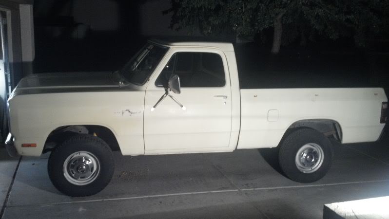

that is the current state of "cupcake". here is kinda the current state of the 2x4 parts truck. it was affectionately known as "little-whitey":

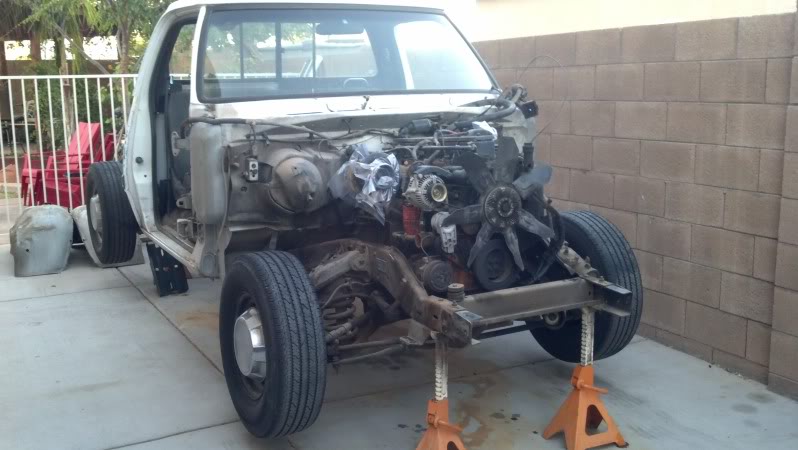

LOL! i have the cab gutted, and ready to come off and head to the crusher

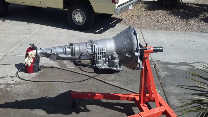

(no place to store it). now the fun commences. time to rebuild the front suspension. clean up and reseal the engine. finish up the tranny. its getting a little DTT love. shift kit, and billet pistons for sure. im gonna try like hell to scrounge up the coin for a DTT converter! then tackle the shortening of the frame. then get it all buttoned back together as complete rolling chassis. WOO-HOO! fun stuff.
Sounds like a fun project. Do yourself a favor and buy a good $550 torque converter from goerend and install that when you put the trans back in, and a 94+ 2nd gen flex plate are stronger than the junky 1st gen ones. Those are 2 things I'd do while it's all out. Tighten up the bands in the 727 and do the line pressure mods and you should have a quick little truck for sure after some tuning.

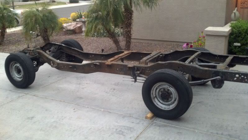

so, its official, little whitey is no more. spent a couple hours scraping crap off, and hosing off the frame:
didnt do any cleaning on the front end, because its all coming apart, and very greasy. the hose wouldnt have done anything anyways. now its time to source a bunch of parts. i need to rebuild the front end. ball-joints, and bushings. i actually had to buy a replacement set of upper control arms. this drivers side arm was effed' up. i found a set on a forum, and they should hopefully be here next weekend. also need to clean the engine. its very-very greasy. then new main-seals, and gaskets. then while i am waitin' on parts, i will shorten the frame. fun stuff! i cant wait to slam this dude together! it is gonna be such a cool truck.
