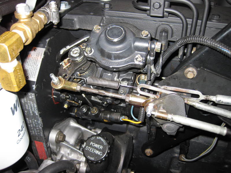

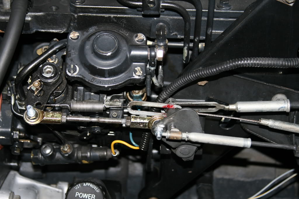

I am surprised that the threads were compatible.
I could be wrong, but I don't think the thread-size is the same between the two valves on the non-I/C pumps.
Quote:
92 Dodge 5.9L TurboDiesel
I am not to sure about the intercooled, but I am pretty sure these cannot be interchanged.
Jim

Jim and Bear Killer - the KSB does not look like the one in the first two photos. it looks just like the fuel shut off valve in the last picture.
i read there was a safety recall on early 1st gen fuel pumps. i suspect mine was changed out entirely.
great pics..Thanks!
